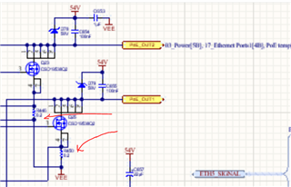

We're running into an issue with our TPS23882B PSE regarding classification in semi-auto mode. Our PD is supposed to classify at class 4, but when we plug it into our board, it's consistently classifying at class 0. Detection is working as expected.
We have the eval kit for the TPS23882B, and when we plug the PD into that, it's classifying properly at class 4, even when using the same register settings. This leads us to believe that there may be an issue with our PSE configuration.

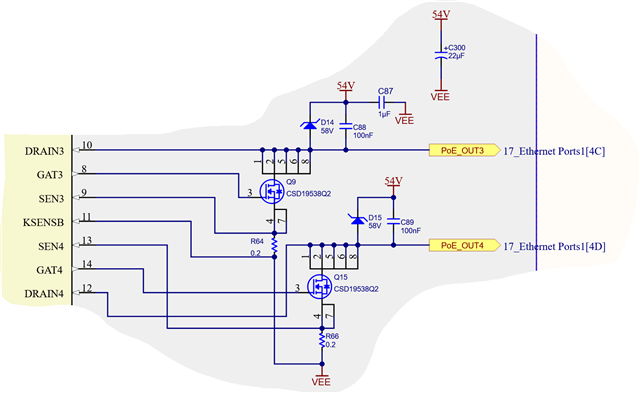

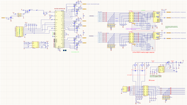

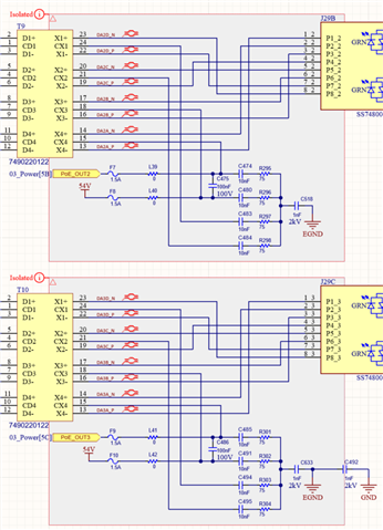

I've attached an excerpt from our schematic that shows how each pair of PoE ports are wired up to the PSE:
Any idea what may be going on that's causing the PD to not classify properly? Please let me know if more information is needed.
  • Hi Noah,
    Thanks for reaching out!
    The PSE schematic looks good to me.
    - Can you also share the PD's schematic?
    - How many channels do you have in the design? Have you tried all channels?

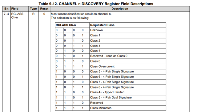

    - Class-0 could be the classification current is too low. And could you check the "DISCOVERY Register" of 0Ch - 0Fh and "ASSIGNED CLASS CHANNEL" Register of 4Ch - 4Fh?

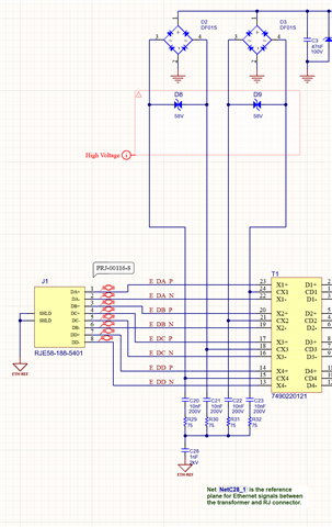

  • Hi Diang

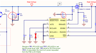

    Kist some more schematic details
    PD RJ45:
    PSE RJ45:
  • Hi Tom and Noah,
    Thanks for the schematic. Still looking for the register dump.
    It may be worth to try to remove C464 and C472 capacitance considering there are too much caps between +DC and -DC or a channel. This may cause detection issue
    Diang

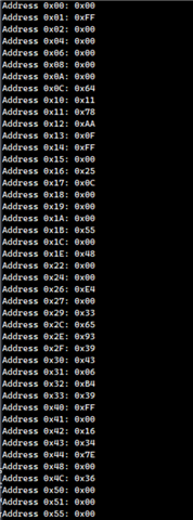

  • Hi Diang,

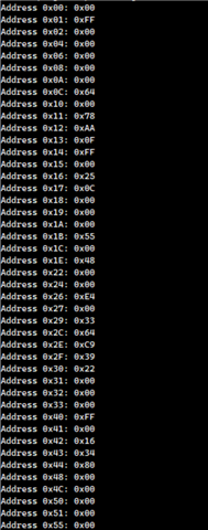

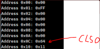

    Here's a dump of the relevant PSE registers taken after channel 1 has finished detection/classification but before power up:
    If we ignore the fact that the classification result was not 4 and power on that port anyways, we get the following register dump after power up has completed:
    I tried to pull all the relevant registers for channel 1, but please let me know if there are others that I missed. Also note that we're servicing and clearing the event and interrupt registers in our code, hence why those registers are all 0. There were no fault events generated by the PSE during the detect/classify/power on sequence.

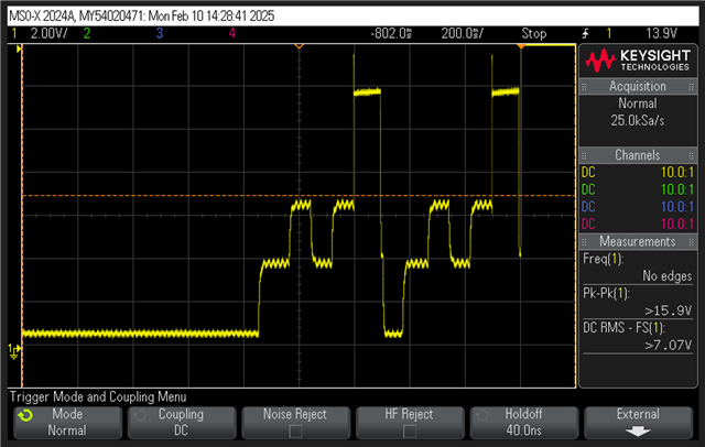

  • Hi Diang,
    We removed those two capacitors from our board, but unfortunately we're still getting the same issue.

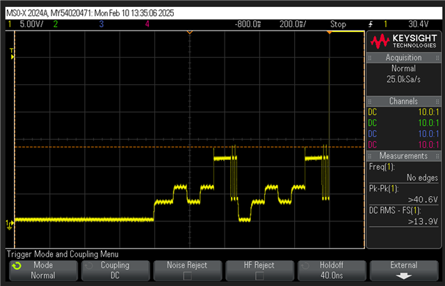

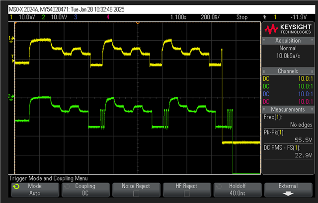

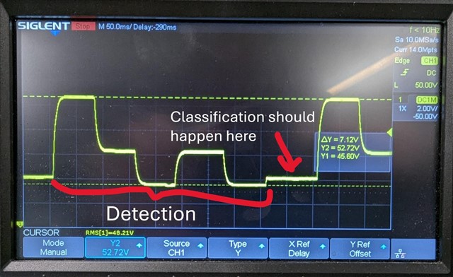

    This is the PSE output detect/classify signature we're seeing on our end, as measured with an isolated scope:
    As you can see from the capture, the detection cycle completes successfully with no issues. However, where the classification stage should start by the voltage being pulled low, instead the voltage stays high.

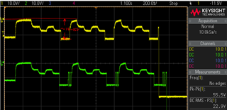

    We have tested multiple boards and what we see is some ports classify correctly and some do not.
    The ports that classify correctly are not consistent between boards - some boards have 2 some 5, so correct classification is not always following channel pairs.

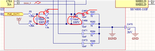

    Yellow: Port classifying as 0 usually, Green: port classifying as 4 (correct) Measured after POE_OUTx fuse
    Each failed Port is different on the voltage before turn on, many look like below which does suggest we are not seeing even close to the 40mA at the PSE 0.2R sense resistor:

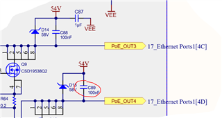

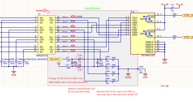

    We made below mods to each of our 6 PoE outputs. See red notes.
    Above mods help. We will see, on average, one or two more ports classify correctly, but in some cases we see no difference on a ports waveform.
    We have tested our PDs (ADI LT4275A) on the TI Boost-PSETHR8 dev board, and they classify correctly so we know issue must be our hardware/firmware.
    Hardware differences between dev board and ours:
    1. Do not have a 1nF 1000V cap between 75R filters and plane under Transformer/RJ45. I did mod two channels (1 pair) up with this mod but saw no difference.
    1a. We are typing RJ45 shield to digital ground for ease of mechanical. I did modify one unit with mode 1 above so RJ45 shield was tied to EGND and saw no change.
    2. FETS are CSD19538Q2 not Q3. Slightly lower power rating (13.1 vs 14A)
    3. 2x 22uF 100V bulk caps on 54V, not 2x47uF 100V

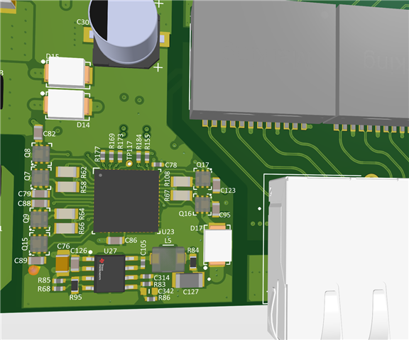

    4. Layout: Do to space constraints the above PoE parts are closer to the RJ45 than the PSE.

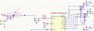

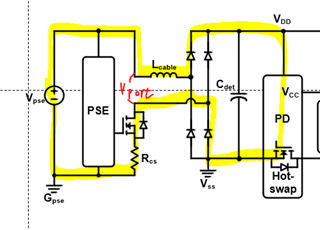

  • Hi Noah and Tom,
    Thanks for your patience. From register map, we did see the 0Ch shows "Request Class-0". What could happen is the classification current is too low. What I see is the port out put voltage during classification is low as ~14 - 15V. This is lower than the 15.5V to 20.5V as expected.
    On the PSE side,
    What may happen is the VPWR pin is not directly connected to the "54V" , this may cause the PSE cannot accurately output port voltage of 15.5 - 20.5V as VPWR - DRAIN. Could you mind to share a full PSE schematic?
    Or if there is any resistance in series with the highlighted loop that cause insufficient classification voltage.

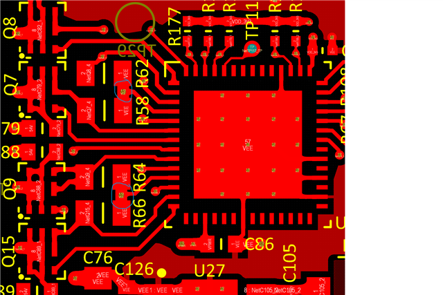

    Another cause may be layout related that cause voltage Kelvin sensing is coupled with current (less possible since Iclass is so low).
    On the PD side,

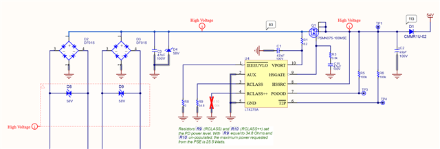

    DF01S as rectifier has a relatively high voltage drop (~0.75V @ 40mA 25C, 0.75V x 2 is the drop) , which may cause the voltage at PD side even lower than turning the classification regulator. A Schottky diode based rectifier will help to alleviate.
    Diang
  • Hi Diang
    Below is the complete PSE circuit & PD circuits
    Your comment about resistance on PoE path is understood. We have modified the Fuse and removed a Ferrite from each PoE output to bring the resistance down. As you can see from schematic there is not much else in the current path. We have tried with short/long Cat5e/6A cables. PoE and PD controller circuits are within ~1.5" of RJ45's...
    What is head scratching is we have many PoE ports that consistently classify correctly, without changing above components to reduce resistance. Most often the ports that do not classify correctly are seeing the lower end of ~8.5-14V, so not even close to 15.5V.
    We do have the PD setup for 4 pair PoE power for future upgrades...not sure if this is an issue?
    I have gone over the layout and nothing is jumping out at me to do with the Sense resistors.

  • Hi Tom,
    Thanks for sharing the full schematic. It may be related to the 1st guess: I saw the VPWR is not directly connected "54V", and port output directly connected to "54V". So the PSE voltage control based on VPWR - DRAIN will have an error with 54V - DRAIN to present 15.5 -20.5V. Could you try to directly connect "54V" to VPWR?
    Diang
  • Hi Diang
    I shorted out the resistor and FET so that 54V (same voltage on PSE output) is directly connected to VPWR (pin 17). No change to Detect voltage or classification on the ports that do not see Class 4.
    What else do you want to see as far as the PSE schematic? We are powering the Device from a AC/DC brick that outputs 54V DC and all we do is filter before sending to PSE and PoE ports.
    thanks tom

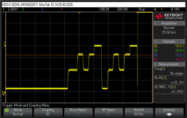

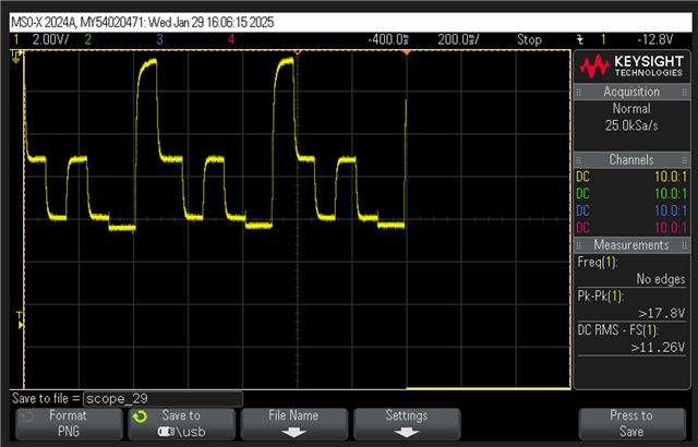

    Capacitance of the Scope affects the classification (using isolation TX on Scope). Measuring at Tranzorb right at PD.
    When I scope ports that previously classify as 4 they now classify as 3 (voltage is ~11.7V). If I let things discharge for a few minutes , often first classification is 4 but all subsequent are class 3.
    Class 4, Voltage is ~11.9V, If reboot will classify as Class 3 below:
    Class 0, Voltage is ~8.1V port that never classifies as 4
    Did some Mods at the PD:
    Short out R1 8.2R resistor at PD VPORT pin - No change
    Remove C1 47nF capacitor at PD VPORT - No Change
    Remove D2 bridge as we are only 2 wire - Unit does not boot consistently but eventually recovers to previous class...interesting...
    thanks tom

    From LT4275 datasheet, it may need a >12.5V voltage between VPORT and GND, otherwise LT4275 may not turn on its classification regulator and result in low classification current. TPS23882B should make a 15.5V to 20.5V at its ports (VPWR - DRAINx)
    We may need to check why the voltage is low at LT4275 eventually. Using the ~8.1V port:
    Step #1: check if VPWR - 54V - DRAINx, make sure they are the same when port is off. If not same, PSE side may have some issue for port voltage control.
    Step #2: During classification, check the 54V - DRAINx voltage, compare with PD's VPROT - GND voltage. Normally 54V - DRAINx will be 0.8 - 1.5V higher than the VPROT - GND voltage due to 2 x DF01S diode forwarding voltage. If the difference is higher than 1.5V, there may be some issue between the PSE and PD that takes extra voltage.
    Step #3: if no strange above, you may use a different PoE PD board and check if that board can pass class-4.
    Diang

    It is looking more and more like we are just not detecting the 40mA correctly at the SENSE (detect lower current), on certain ports only regardless of what is hooked up (in some cases the 2 ports on a single SENSE will detect differently, one correctly the other not even close).
    Not able to scope the sense resistor without affecting reading.
    The layout is quite tight and I only have one via connection on each KSENSx to a dedicated ground layer (have 4 dedicated ground layers that connect this via to PSE Ground pad). I would not expect this single GND connection to affect the low current sensing though (as you mentioned)? We do seem to be detecting and tripping at 29W (ILim) reliably.
    Could there be a firmware aspect to this that we are missing?
    Do you have gerber's for the TPS23882B1EVM-008? hard to tell from pdf's.

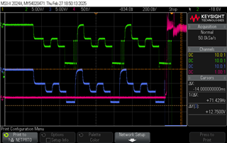

  • Hi Diang,

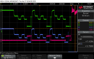

    I'm helping Tom and Noah investigate this issue. I tested the current drawn (using a non-invasive clamp-style current probe on the CAT5e cable) by the PD on 2 ports: one which classifies correctly, and one which doesn't. These ports are connected to the same PSE. The pink waveform shows current during the classification stage.
    When classification succeeds, I see the expected 40 mA draw from the PD (below - pink current measured on the green waveform's port).
    When classification fails, I see 0 mA draw from the PD (below - pink current measured on blue waveform's port). I agree that this is very likely due to the voltage seen by the PD being less than 12.5V.
    Do you have any ideas as to why the PSE is supplying less than 12.5V?
  • Hi Daniel,
    Thanks for your helping.
    We pervious discussed some possibilities that will cause port output less than 12.5V. I guess below two issues could be checked:
    1. From PSE side, it should output VPWR - DRAIN as 15.5 -20.5V. Shorting 54V and VPWR to make sure PSE have a correct sensing voltage.
    2. I just noticed the two Bob Smith termination grounds are shorted, it may be a cause since when upper port is on, the Bob Smith termination ground is (54 + 0)/2 = 27V, but when below Bob Smith termination ground is doing classification as 20V, the Bob Smith termination ground is (54 + 34)/2 = 44V. This may also cause port voltage output issue. You may try to disconnect these two grounds and retry.
    Diang
  • Hi Diang
    1) We shorted 54V directly to VPWR at pin 17 previously  - no change.
    2) We had already changed the Bob Smith terminations to add a 1nF 2kV cap in series with the Reference plane under RJ45's/ethernet transformers for each Giga Ethernet channel - no change.

  • Hi Diang,
    I have found the root cause of our problem. Since we have a FET gating VPWR to come up after 54V, the PSE sees a spike of 26V on all drain pins, as it is being back-powered through the 54V/drain capacitors and into the DRAIN pins of the PSE.
    I confirmed this by connecting VPWR directly to 54V and replacing the PSE with a brand-new component. After doing this, all 6 ports classified correctly. I then reverted the change so that VPWR comes up after 54V through the MOSFET, and all 6 ports failed to classify correctly.
    Thank you for the assistance on this.
