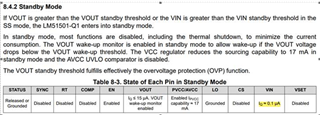

I am confused about the Vin range of LM5150-Q1.
Since the target output from customer is 8.5V, and above 8.5V, they need the system enter the bypass mode (Standby Mode).
And in the standby mode, I think the chip is mainly disabled, but I am not sure whether LM5150-Q1 can suffer under 50V Vin.
Thanks a lot for your support, looking forward to your reply.

  • Hello Matt,
    As per the datasheet:
    1. Features:
    Wide VIN input range from 1.5 V to 42 V when VOUT ≥ 5 V (65-V absolute maximum)
    7.1 Absolute Maximum Ratings: VIN, VOUT, EN to AGND: 65V
    7.3 Recommended Operating Conditions: VIN, VOUT, EN to AGND: 42V
    This means:
    The process that is being used for this device can sustain voltages up to 65V.
    Above 65V the device will get damaged.
    The recommended maximum voltage is 42V, which means that the device has only been tested up to a supply voltage of 42V
    and the regular long-term supply voltage should remain below that.
    In case of short voltage spikes up to maybe 60V (e.g. because of a load dump) the device will survive.
    But, for the range between 42V and 65V, we do not guarantee any linearity nor a predictable behavior of the device.
    The LM5150 will anyway not be switching in that voltage range, so I would not expect any issue there.
