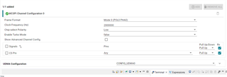

  • Here are the settings for SPI and CS. Let me know if you need any further information. If you provide I can send you the screen shots of configuration.
    const mcspi = scripting.addModule("/drivers/mcspi/mcspi", {}, false);
    const mcspi2 = mcspi.addInstance();
    mcspi2.$name = "CONFIG_MCSPI1";
    mcspi2.initDelay = "8";
    mcspi2.SPI.$assign = "SPI1";
    mcspi2.child.$name = "drivers_mcspi_v0_mcspi_v0_template1";
    mcspi2.mcspiChannel[0].$name = "CONFIG_MCSPI_CH1";
    mcspi2.mcspiChannel[0].bitRate = 2000000;
    mcspi2.mcspiChannel[0].CSn.pu_pd = "pu";
    mcspi2.mcspiChannel[0].CSn.$used = false;
    mcspi2.udmaDriver = udma1;
    mcspi2.SPI.CLK.$suggestSolution = "SPI1_CLK";
    mcspi2.SPI.D0.$suggestSolution = "SPI1_D0";
    mcspi2.SPI.D1.$suggestSolution = "SPI1_D1";
    Chip select
    gpio2.pinDir = "OUTPUT";
    gpio2.$name = "SPI1_CS1";
    gpio2.trigType = "BOTH_EDGE";
    gpio2.defaultValue = "1";
    gpio2.GPIO.gpioPin.pu_pd = "pu";
    gpio2.GPIO.gpioPin.$assign = "SPI1_CS1";
    gpio2.GPIO.$suggestSolution = "GPIO1";
  • Additional information: I can write values 0x01, 0x02, 0x04, 0x08 to TPS274C65 register 0x4D, which doesn't exist to see Red LEDs turn on based on the values set and SW channels get enabled and we notice a couple of heaters turn on.

  • Anil, your suggestions worked. I made few changes:
    1. re-created project from scratch.
    2. change the mode to POLO, PHA1.
    3. enabled CS as part of MCSPI transaction.
    4. removed extra MCSPI_transfer we were doing to deal with issue with other third-party peripherals. Now only doing single transfer.
        transferOK = MCSPI_transfer(gMcspiHandle[CONFIG_HEATERSPI], &hSpiTransaction);
    Thanks for the support.
