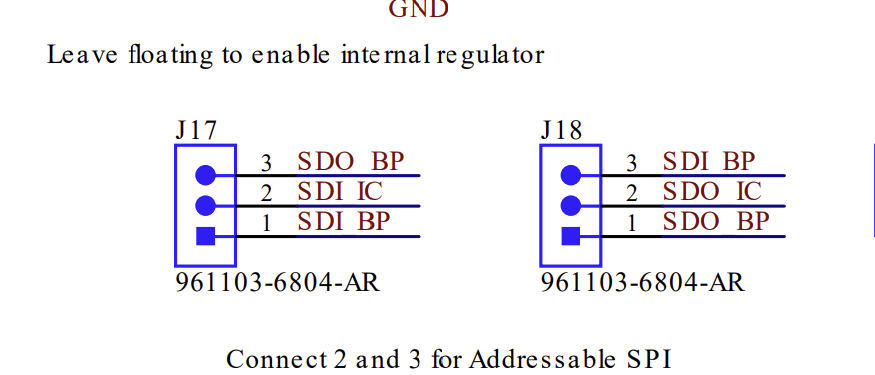

    The regular non-USB EVM is meant to be able to work in all different configurations: addressable SPI, daisy chain SPI, and standalone. If the USB EVM is working with your Pi and the regular EVM is not, this makes me think that maybe the regular EVM's jumper configuration might not be setup correctly to match the SPI frame that you are sending from your PI. Could you send a closeup of the jumper/dip switch configuration of the non-USB EVM? It's possible if you are using addressable SPI that the address might be mismatched.

    Could you unpopulate those jumpers and just tap into pin 2 for your MOSI and MISO lines?
    Since you are cycling addresses I a going to make an assumption that the address configuration is not an issue.

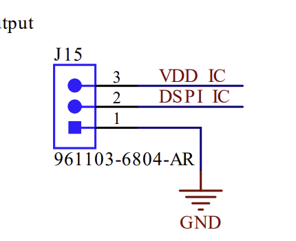

    It's hard to see explicitly from the picture, but could you verify J15 is set to 1-2 position (enabling addressable SPI)?
    Tim
  • J17 and J18 were already as you have described. However, fixing J15  fixed the issue. SPI EVM board does work now.
     However, “TPS274C65 Evaluation Module SLVUCI0 – MAY 2022”  documents say to connect 2-3:
