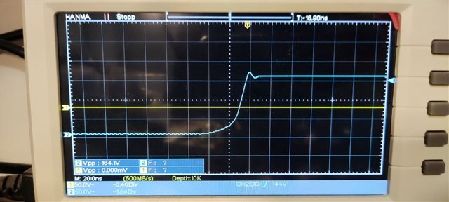

yellow at current sense resistor with 0.05 ohm, get with springs on
Blue - on MOSFET source with 110v output and 20mA load
with more magnification:
Output voltage is still stable, but losses at MOSFET are very high, what it the problem ?

    Can you make a waveform measurement of the switch node signal?
    So you have have only share the driver and current sense signal.
    Thanks and best regards,
    Niklas
  • now i have only one MOSFET 9N40, and at drain-inductor-diode point i can get 20nc rise and 5nc fall time
    but efficiency is still poor, it mosfet is cold i have 82-84% but if it will be hotter - efficiency go down to 74-70%
    But i have redesign all ground connection as you describe as short as possible, replace MOSFET to STD33N60M2 with 600v / 0.125 Ohm, and ordered new PCB ..
    Will see how it will work ...
  • Hi I R,
    Looking at the waveforms, there is one additional notice I have not commented on so far.
    The rise time of the SW takes about ~40ns. This is when the MOSFET gate is closing. The fall time only takes ~5ns.
    The long rise time may add to the losses, so common designs speed up the rise time of SW either by adding a 10kOhm resistor from gate to source, or by adding a diode in parallel to the gate resistor.
    This can lead to worse EMI performance, but could increase efficiency.
    Niklas
