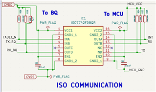

I have developed a PCB with the BQ79656 IC, and the isolation board is a separate PCB with capacitor isolation, as described in the BQ79656 datasheet under "Capacitor Isolation on Different PCB." We tested the setup using USB2ANY via the 10-pin connector connected to the BQ79600 EVM, using the cable provided with USB2ANY. The BQ79600 COMH is connected to the custom board’s COML.
Out of the five boards assembled, only two are working. All five boards receive the wake-up signal, and the LED connected to AVDD turns on when the wake-up command is issued through the GUI. However, the Auto Address function does not produce any results on three boards.

  • Hey Arun,
     This issue is generally due to an incorrect isolation schematic, poor connection between isolation components, or the BQ79656's power supply is clamping the input current (a current clamp around 50mA or more is fine). Can you provide you isolation schematics to be reviewed?

    Sorry for the late reply. I debugged the problem, and the issue was with the isolation circuit on the two non-working boards. The isolator was mounted, and we were trying to communicate using the COMH and COML ports. Once we removed the isolator (ISO7742FDBQR), both boards started communicating.
    I have attached the isolator schematics:
    Even when the isolator is not mounted should we populate the pull-up resistor for RX_BQ?
