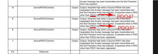

I'm currently evaluating a sink-only design without USB d+/d- and USB BC support. But I need some clarification regarding SourcePDO* GPIO events (#7~#13).
1. Are there any typos in these descriptions [a]?
2. What is the relationship between SourcePDO[4..1]Contract (#7–#10) and SourcePDOContractBit[2..0] (#11–#13)?
* For example, if PDO1 is the contracted one, would SourcePDO1Contract be asserted while SourcePDOContractBit[2..0] becomes {Deassert, Deassert, Assert} simultaneously? (Values shown as { SourcePDOContractBit2, SourcePDOContractBit1, SourcePDOContractBit0 }).
3. (Follow up of 2.) If the contracted PDO# is greater than #4, is it only represented in SourcePDOContractBit[2..0]?
4. Can SourcePDO[4..1]Contract (#7–#10) and/or SourcePDOContractBit[2..0] (#11–#13) serve as active indicators for a specific sink PDO to enable a system load [b]?

    1. Thank you for highlighting these typos. Your understanding is correct.
    2.  These GPIO events are typically used to enable the External DCDC output. The Source PDO Contract GPIOs (#7 - #10) are asserted high when a Source PDOx (x<= 4) has been negotiated, whereas the SourcePDOContractBit GPIOs (#11 - #13) use a binary encoded output to indicate when a Source PDOx has been negotiated (think of a truth table here).
    3. Correct. For PDO # greater than 4, SourcePDOContractBit GPIOs should be used instead.
    4. These GPIOs are asserted when the PD is behaving as a Source. They will not be asserted when the PD is behaving as a Sink.
