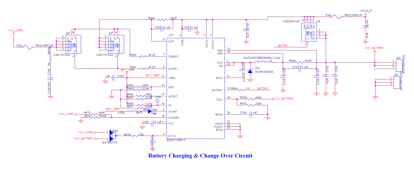

I'm sorry to say, but I still have the fault indication even after trying your suggested corrections. Could you please suggest any other reasons that might be preventing it from working?

One more thing to try is to change the R659 and R661 to 4.02kohm, currently you have them as 40.2kohm, this is correct.

I'm not sure if you are using an external thermistor, one more thing is to try and ad a 10kom resistor to the TS resistor network.

Can you measure the voltage on some of the pins?
REGN, OVSET, TS, ACSET, VREF.

I don't see any other obvious issue with your schematic, do you see any changes if you increase your input voltage? is there a current limit on your adapter?

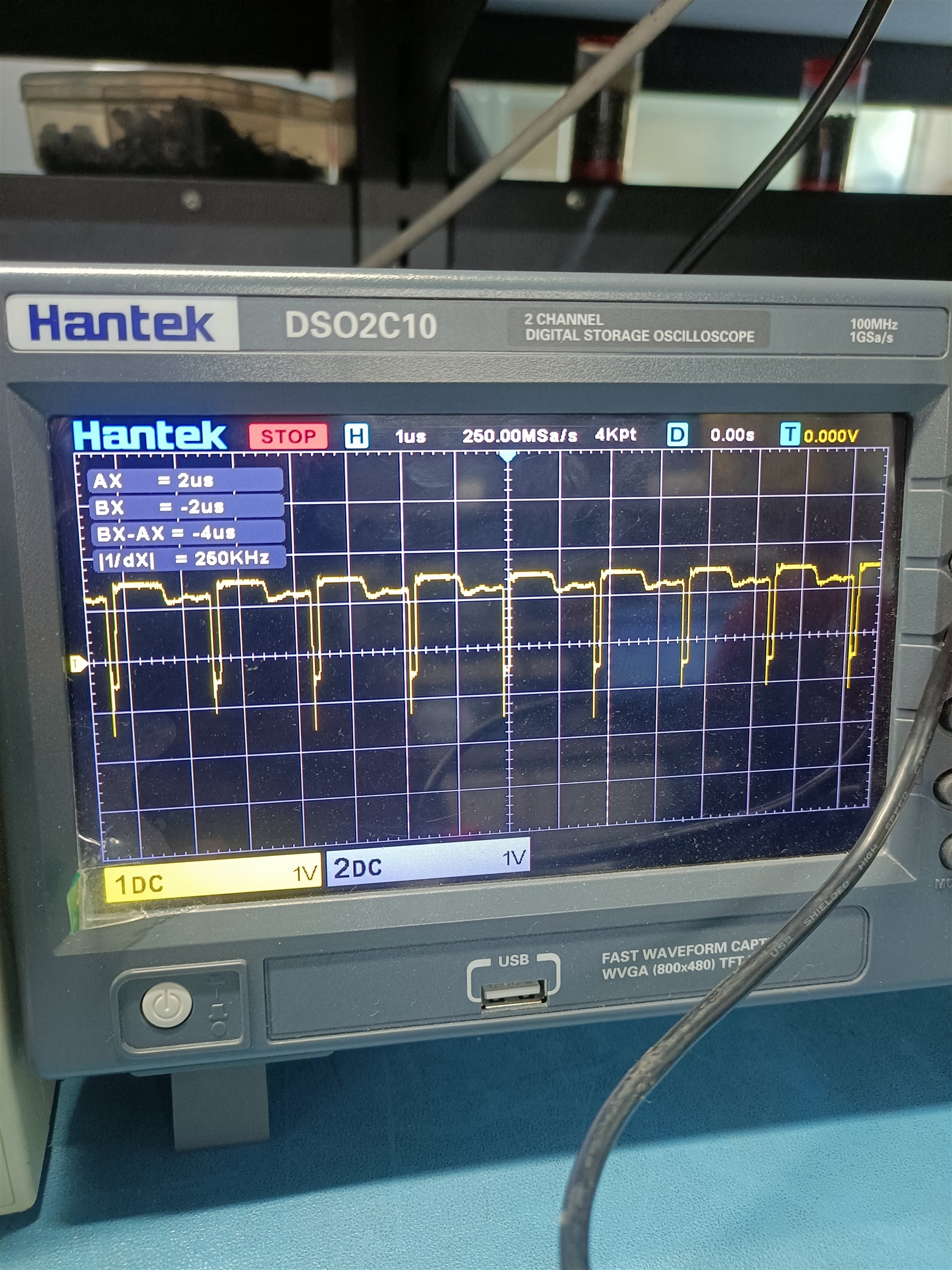

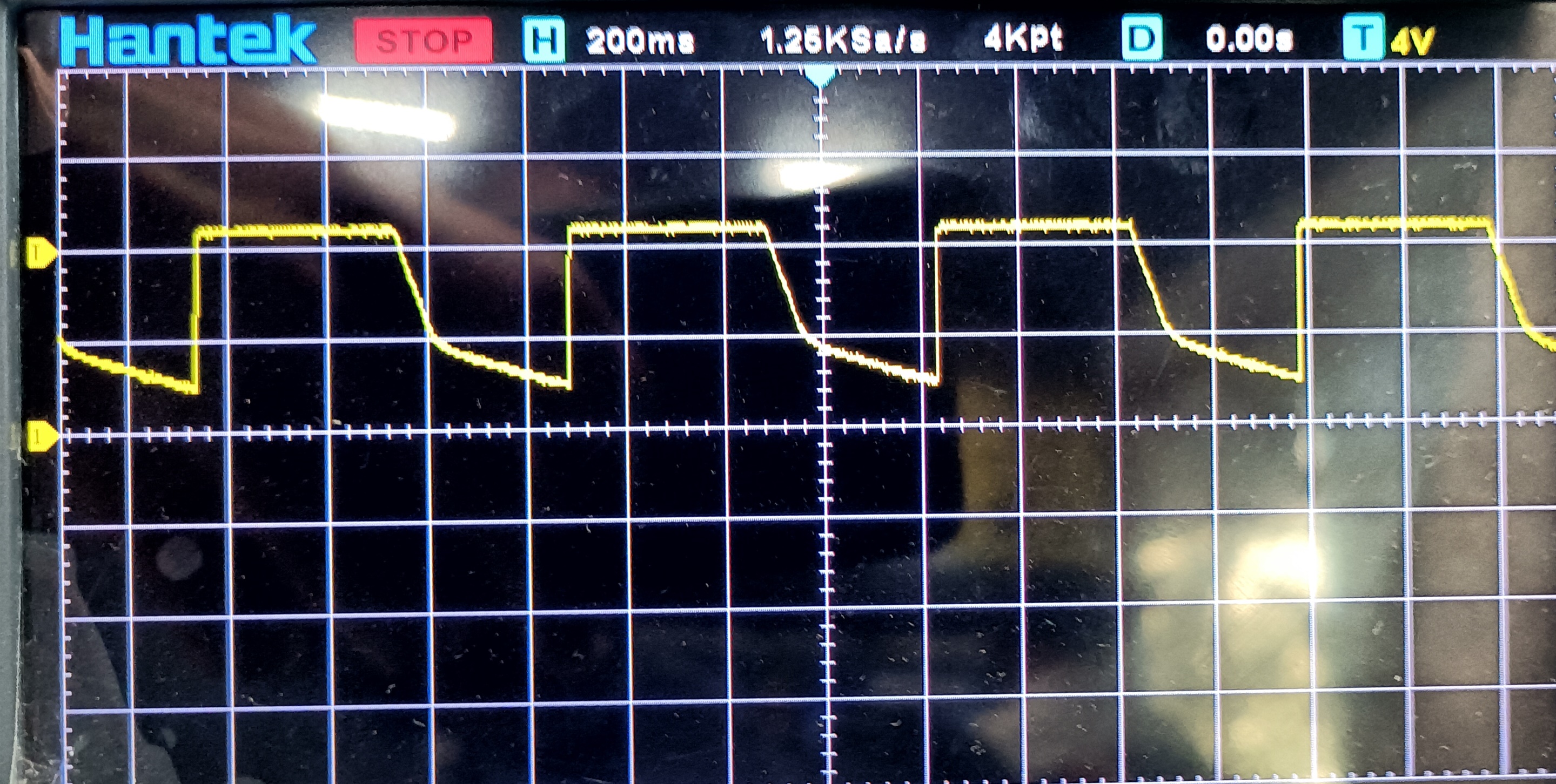

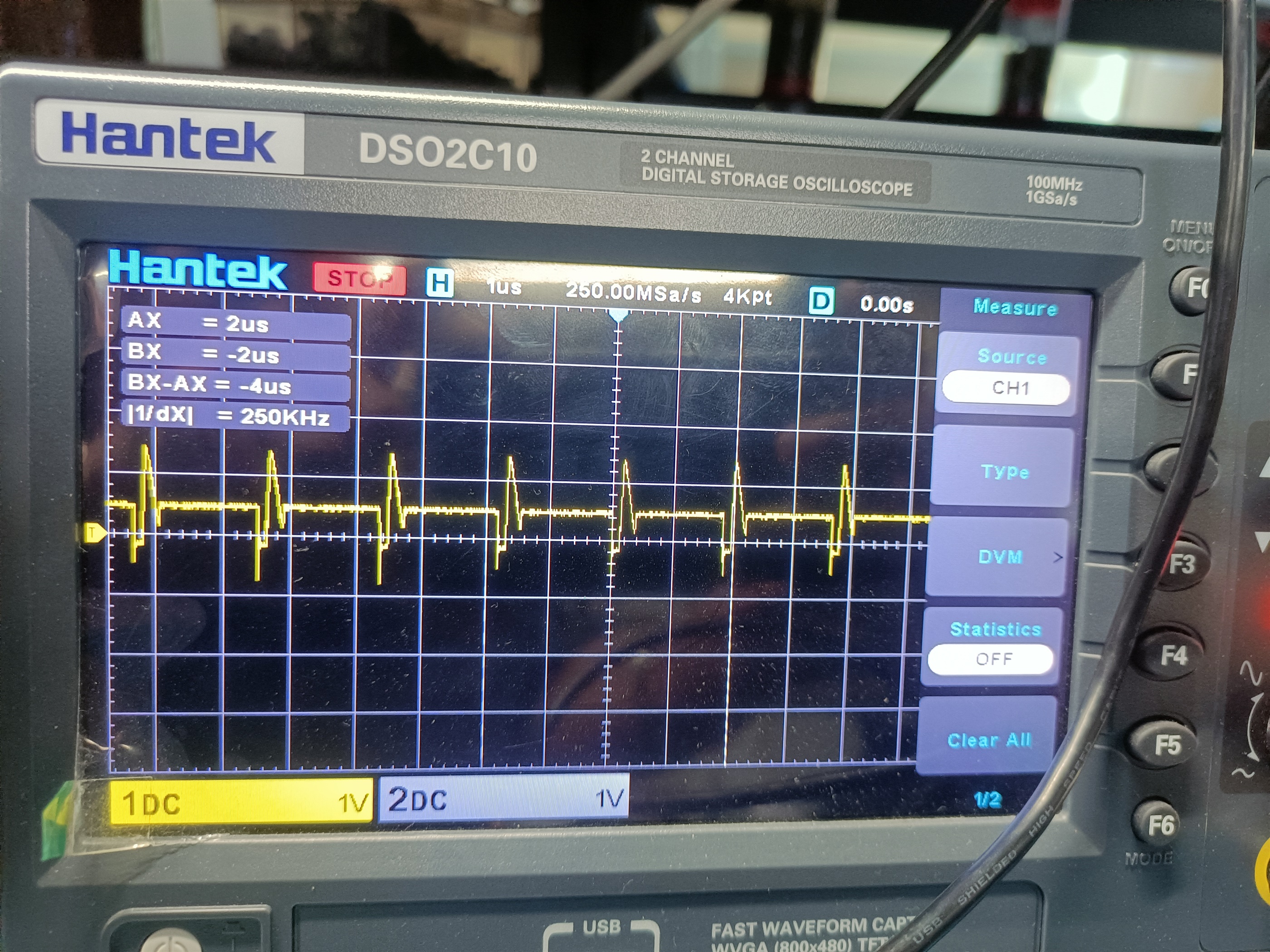

Hello Christian,
I've checked using different power sources, and to provide more clarity, I’ve attached some pictures of my observations. Kindly take a look when you have a moment.

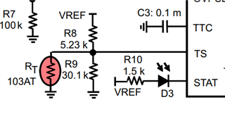

Hello Chaitanya,
It looks like the TS resistor divder is wrong, one more thing to try is to change R671 to 30.1kohm and and R669 to 5.23Kohm.

No, the 10kohm resistor was to act as a thermistor, in some of our devices the thermistor is required.
My thought is to change the resistor divder on the TS pin:
Please refer to Section 9.3.18 Temperature Qualification: are typical recommendation is to use a 5.23kohm and 30.1kohm.
This is typical circuit:
This is your circuit, I'm not sure how these values were chose, these values seem reaaly high.
So, I first recommend changing R669 and R671, if this does not work, add in the 10kohm resistor to act as the thermistor. Please let me know if this works.

Hello Christian,
Apologies for the delay. I checked the circuit using your corrections. I removed the 10K resistor in parallel with R671 (30.1K), but the stat pin still blinks. I then replaced the 10K resistor in parallel with R671 (30.1K), and R669 is 5.23K. However, the issue remains the same. I also used a 1A load. While using the load, the STAT LED glowed continuously, even when I removed the source. When the load was on the battery, the LED did not stop glowing.

Can you provide an update to date schematic, to confirm all of the suggested changes?
Have you tried replacing the IC? it could have been damage previously.
Can you confirm that the 10k resistor is only in parallel with R671?
What is the voltage on the cell/FB pin?

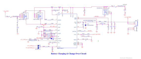

Hello Christian,
The voltage at the cell/FB pin is 1.99V. I don't believe the IC is damaged because everything is working fine, and the transistors are switching as expected. However, I haven’t noticed that the battery is being charged. The STAT pin always blinks. Also, please check the attached updated schematics. And thankyou for your assistance. I hope we can solve the issue.
