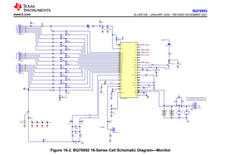

  • Hi Alexis,
    Do you mind sharing a schematic of your connections?
    We connected the circuit as shown in below, which we got from the BQ76952 data sheet.
    When you said you connected REG1 to 3.3V, are you supplying 3.3V to REG1?
    Yes, we are giving 3.3V to REG1 from the MCU.
    Also, do the SDA and SCL lines have pullups to REG1 or 3.3V?
    The pullups (10kohm each) are already linked to 5.0V from the MCU side.
    Hareesh
  • Hello Hareesh,
    Thanks for clarifying. REG1 is an LDO that can output voltages at various levels, so you would not need to supply 3.3V from the MCU to it.
    Thanks for confirming this. Could you share any logic analyzer files of the SCL/SDA lines when you try to communicate? What commands/subcommands are you sending? Also, what is the voltage of REG18 and RST_SHUT as you try to communicate with the part as well?
    Alexis

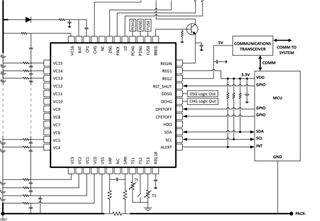

  • Hi Alexis,
    Do you mind sharing your schematic?
    We are referring the following reference design which was mentioned in the BQ65952 data sheet.
    We connected the following pins between the MCU and the BQ7695202 AFE based on the reference design:
    DFETOFF
    RST_SHUT
    ALERT
    SDA
    SCL
    GND.
    Please advise whether there are any pins I should connect in order to read the AFE's cell voltages.
    1. Does your MCU support clock stretching?
    Yes, the MCU will support the clock stretching.
    We are giving the I2C device address as 0x10.
    Hareesh
  • Hello Hareesh,
    Were you able to communicate before any configuration changes were made or did communication stop after configuration changes were made?
    Are you driving voltages to the DFETOFF/ALERT pins or any other pins of the AFE?
    There shouldn’t be any other pins that need to be connected to read the AFE’s cell voltages if SCL/SDA are connected properly to communicate with the device and the cells are attached.
    Since you can’t communicate with the device, you aren’t going to be able to read the cell voltages. I’m trying to determine where/when this communication issue occurred.
    REG18 shouldn’t be reading 3.8V, so it would be good to determine how it’s going so high.
    Alexis
