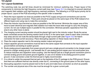

    • Does the BQ24133 generate a significant amount of heat?
    • How is heat typically managed in this device?
    I would recommend following the Layout guidelines in the datasheet for the best way to reduce heat to the IC.It is critical to solder the exposed thermal pad on the backside of the IC package to the PCB ground. Ensure that there are sufficient thermal vias directly under the IC, connecting to the ground plane on the other layers.
