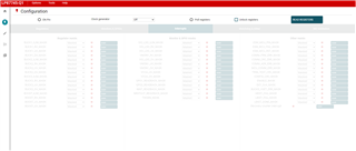

  • Hi Katie,
    Is this setting right? If yes, it still cannot work normally.
    and the register bit or GUI options will jump back to the default setting automatically.
    Thank you!

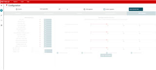

  • Can you share with screen captures or short recording exactly how you are attempting to perform the write/update, step-by-step? This will help us see what is happening.
    Katie
  • LP87745-GUI setting issue.pdf
    Thank you for your help~
    Ted
  • Hi Ted,
    Before changing the Vout default settings, first make sure the registers are unlocked and make sure the watchdog is disabled. Probably the watchdog gets out of long window and the device gets repeatedly reset if the WD is not answered.
    General power up instruction to follow.
    1. Power up the device and make sure the GUI gets connected successfully.
    2. Try to disable the watchdog from GUI in "Watchdog and other " tab. Uncheck the WD reset enable and enable and check the hold on and return to longwindow options. Below is screen capture for normally enabled WD condition.
    3. Try to clear all interrupts.
    4. Now try to change the Vout voltage. Remember if you do any changes to registers from 0x15 to 0x44 then you need to mask the CRC config as well before doing any changes.
    If you are still unable to do it let us know.
    Ishtiaque

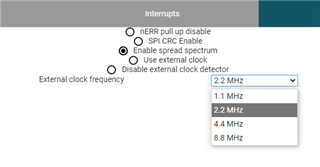

    How about "Enable Spread Spectrum" item, it has the same problem which cannot be commanded sucessfully. It has gating for what's function?
  • Hi Ted,
    Enabling Spread Spectrum should not cause issue if you are first masking the config CRC registers. If you are not masking them then you will get Orderly shutdown of rails as soon as you try to enable SS.
    In GUI, "Interrupts" section, Mask the register CRC following below step.
    After clearing all the interrupts
    1. Mask first "CONFIG_CRC_MASK" and read registers
    2. Then Mask "TRIM_TEST_CRC_MASK" and read registers
    After that enable the SS.  Let me know if the issue is different than this because to my understating you might be getting issue with enabling SS because of CRC error.
    Ishtiaque
  • Hi
    it works. But, I would like to know what's the function for "Clock generator" and "Use external clock" ? because I dont know which choose for PMIC operating itself. PMIC's spread spectrum cannot be affected by other clock source from other IC on the EVM.
    By the way, I only see total 4 option clock, it does now show the 17.6MHz or higher clock options. The reason is?
