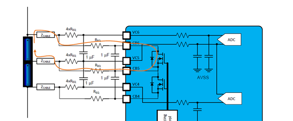

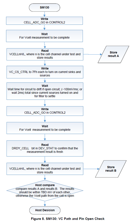

We have implement SM130 according to Safety Manual in our project.
At normal ambient temperature, when we inject current sink and current source, the cell voltage will change about 50mV, it is consistent with the datasheet.
but when we test it at low temperature(about -40℃), the cell voltage only change about 31.3mV. according to datasheet and safety manual, the minimum threshold is about 37mV(the resistance(4xReq) is about 100Ω, the minimum of current sink is 0.17mA, and the minimum of curren source is 0.2mA). So we don't understand why the actual difference less than the minimum threshold.
Can you help us analysis this question?
Note:
in picture 4:
[Yellow]CellVolt::_0_ is the voltage of cell 1, the unit is 0.1mV;
[Red]CellVolt_OC::_0_ is the voltage of cell 1 when inject current sink and current source, the unit is 0.1mV;
[Cyan]DeltaVolt::_0_ is the difference between CellVolt::_0_ and CellVolt_OC::_0_, the unit is 0.1mV

    So I believe the issue here is that when you are enabling current sinks and sources, this is causing voltage differences in the ADC readings. This is being made worse at low temperatures due to the cooling of the silicon changing both the current sources and ADC measurements. Essentially accurate cell voltage measurements cannot be made during current source/ current sinks being enabled. These two actions need to be done separately.
    Thank you,
    Zachary
  • Hi Zachary:
    Thank you for feedback. So the low temperature will make the silicon measure accuracy more worse, right?
    We enable current source/current sink just want to implement SM130 diagnose according to safety manual.
  • Hello Zizhen,
    Temperature can have a strong effect on the ADC accuracy. The big factor here is to ensure that ADC readings are made without sinks and sources being enabled. This will make sure that the readings are accurate. As you can see in the manual, there is a wait time after disabling the sinks and sources so that this doesn't have an effect on ADC readings. ADC results should be accurate following this process.
    Zachary
  • Hi Zachary:
    As you can see in the process of SM130, the result B is the measured value of cell voltage after enable current source and current sink. and the problem is the result B isn't accurate.
