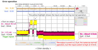

Dear Sirs and Madams,
We are currently verifying the operation of LMZM23601.
VOUT:8V
IOUT:2.5uA
Currently, for all products, when VIN is 9.6V, the input current is approximately 400uA.
However, we found that when VIN was 9.5V, there were some products with an input current of approximately 400uA and other products with an input current of 4.5mA to 5mA.
When I checked the maximum duty cycle on the data sheet, it was 91% (typ), but what is the expected minimum value?

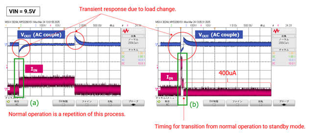

When observing the output voltage, we can see that there is a difference in the switching period.

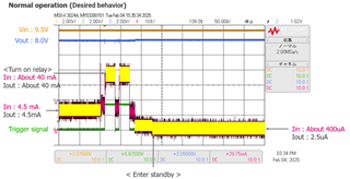

[ VIN = 9.5V to 9.6V, IIN = 400uA ]
The switching frequency is about 1kHz (1ms).
[ VIN = 9.5V, IIN = 4.5mA to 5mA ]
The switching frequency is about 66kHz? (15us?).
The load current is 2.5uA for both of the waveforms above.

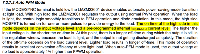

In the waveform below, I suspect that the cause of the increase in input current (IIN) is that the high-side FET is not completely saturated right?
Please could you provide us your opinion on the cause of this issue.

    I thought the problem was that the input current was increasing as the input voltage decreased, so I wanted to know the minimum value of Dmax.
    We will obtain the waveforms of Vout, Iin, and Iout and report them later.

  • Hello Masashi,
    Could you please probe the waveforms during this transition also: Vin 9.6V to 9.5V, Iin 400uA to 4-5mA in oscilloscope and share with us?

  • Hello Arpita,
    I have attached a PowerPoint file summarizing the waveforms for the problematic operation of the LMZM23601.
    The customer is using a digital multimeter for the load current because the current is too small to be measured with an oscilloscope.
    LMZM23601_waveform.pptx

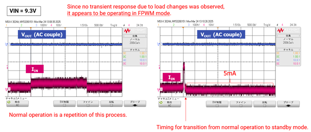

    The LMZM23601 that the customer measured this time works normally up to an input voltage of 9.5V, but when the input voltage drops to 9.3V, the input current does not drop.
    There seem to be a variety of cases, including some that occur when the input voltage drops from 9.6V to 9.5V, and others that occur when the input voltage drops from 9.5V to 9.3V.
    The results of this measurement are the latter.
    Because the LMZM23601 is being used in a battery application, the customer wants it to operate with low current draw without abnormal conditions from input voltages ranging from 9.3V to 16.8V.
    If you have any questions or need any information please feel free to contact us.

  • Hi Masashi,
    I have tested and confirmed in the EVM. Please note that this behavior is expected in low drop-out mode. As Vin reduces nearly to Vout> initially Vout starts falling as the internal Error Amplifier initially tries to maintain previous duty >COMP increases> COMP min threshold is crossed, thus the mode shifts to FPWM, even at very light load. While operating on FPWM mode at low load, the efficiency decreases (Refer to datasheet).  Do you have any further concerns regarding this?
    Arpita
  • Hello Arpita,
    Customers want an operation in which the input current does not increase even when the input voltage decreases.
    Is there a way to avoid this issue?

    The device enters into FPWM mode in low drop-out region [vin=~9.3V to 9.5V.] The difference in Vin that you see is ~200mV, which could happen due to part to part variations. The device should not enter into FPWM at Vin=10V at light load.
    From datasheet, it seems like we don't provide this kind of data for this device. However, I will try to check internally if min. value of maximum duty cycle of this can be provided.

    I have checked in EVM. I do not observe the mode shifting at Vin=10V, Vout=8V, at very light load in EVM. However, I will confirm with design team for the margins. I will get back to you once I hear from them.

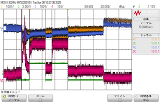

    Below are the waveforms that were investigated to determine the drop in input voltage in response to your answer.
    You can see the difference in operation when Vin=9.5V and when Vin=9.3V.
    Since it is difficult to read the current value from an oscilloscope, the values ​​shown are those obtained using a digital multimeter.

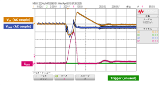

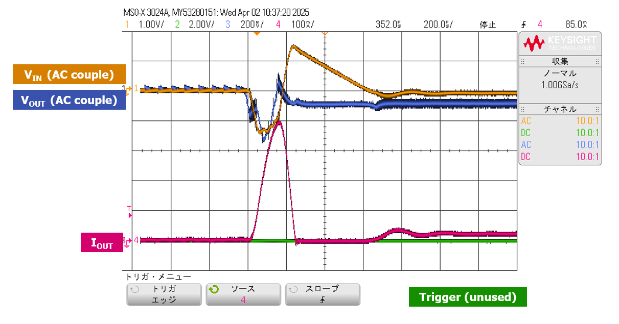

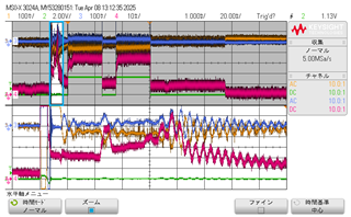

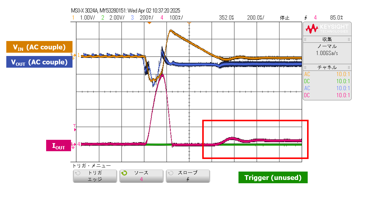

  • Hello Arpita,
    The waveform obtained by adding the input voltage (battery voltage) to the waveform in the previous thread is shown below.
    The input voltage and output voltage are set to AC so that voltage fluctuations are easy to understand.
    And one division of the input and output voltage is 100mV.
    Please contact us if you have any information you would like.
    Masashi

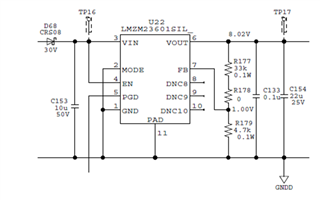

    Thanks for the complete waveform. Can you please share your schematic for double-check? May I know what are the input capacitors you have used? What is the slew rate of load transient?
    Arpita

    1.
    [Ans]
    Input capasitor is 10uF/50V ceramic capasitor.

  • Hi Masashi,
    Thanks for the information. The schematic looks good. As I have told previously, it is very difficult to calculate the entry point (where mode shifts) of vin exactly, and the behavior of mode changing is quite expected behavior, let me check internally if I can get the data (if any).

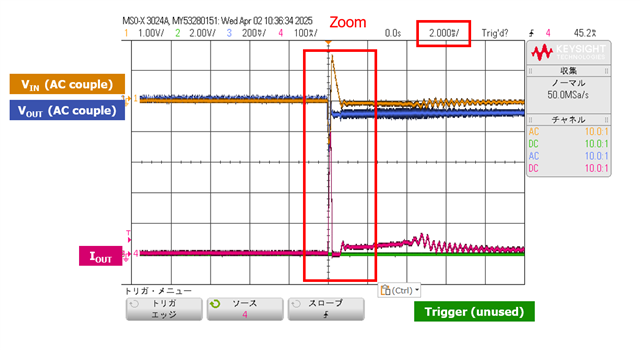

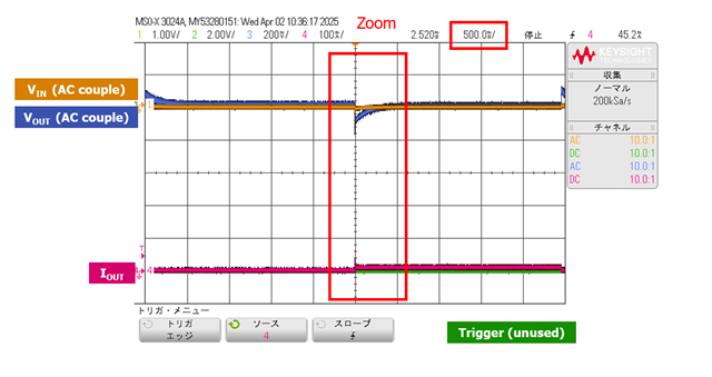

  • Hello Arpita,
    The load change transient response waveform is attached below.
    Channel 4 (Red) is an enlarged waveform of the output current.
    The time axis is 200us/div, and the current value is 100mA/div.
    Input current slew rate is about 400mA / 160us = 2.5mA / us.

  • Masashi,
    Your previous waveforms and the latest waveforms looks like they have taken in different instants/test conditions.
     Please get back to us once you have vin,vout, iout, Iin captured in single waveform , as I have asked in my previous replies. It will be helpful to debug further and rule out any other issue.
    Arpita
  • Hello Arpita,
    Until now, I had only been observing the current on the input side, but when I maximized the waveform of the load fluctuation on the output side (Iout), I found that it was the waveform I have attached.
    Because it is a fast, instantaneous fluctuation, it may not be possible to observe it on the input side.

  • Hello Arpita,

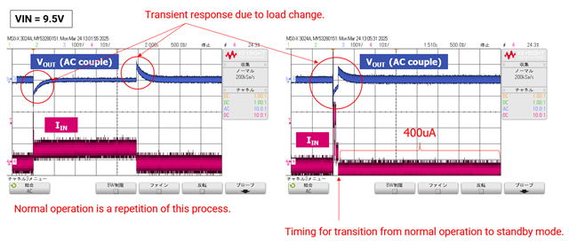

    When you say slew rate, what timing load change slew rate do you mean?
    (a) Load change during normal operation
    (b) Timing for driving the relay before transitioning to standby mode
    The waveform we are sending is a load fluctuation waveform under normal operation (a).
    The customer's normal operation is approximately 0 to 50mA load variation.
    In other words, the red frame in the sent waveform corresponds.
    The slew rate is 50mA/200us = 250uA/us.
    Does this mean that the output current fluctuation waveform under condition (b) is absolutely necessary?
    Similarly, regarding the single waveform you mention, which timing waveform do you need?
    Masashi

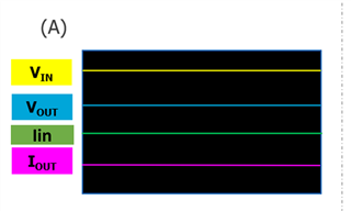

  • Masashi,
    Please try to capture like below and share if you can get the waveform like this. However, I will get back to you once I hear from design team internally.
  • Hello Arpita,
    If there were two current probes, it might be possible to fit the waveform on one sheet, but since there is probably only one current probe, it may be two sheets, Iin and Iout.
    I will ask the customer to retrieve these waveform.
    Masashi

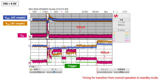

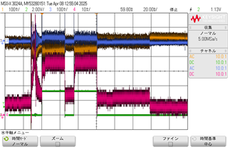

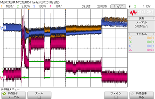

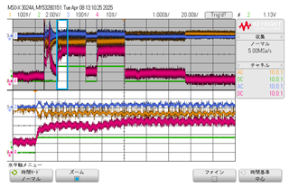

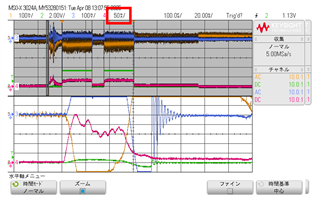

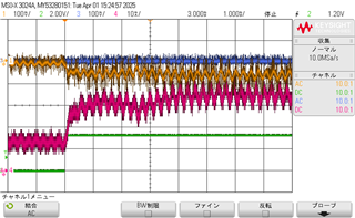

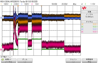

  • Hello Arpita,
    Because there is only one current probe, there will be two waveform images, Iin and Iout.
    (A-1) Vin = 9.5V (Yellow), Vout (Blue), Iin (Red)
    (A-2) Vin = 9.5V,(Yellow), Vout (Blue), Iout (Red)
    (B-1) Vin = 9.3V (Yellow), Vout (Blue), Iin (Red)
    (B-2) Vin = 9.3V (Yellow), Vout (Blue), Iout (Red)
    We feel that there are no major differences in the above waveforms.
    The waveform shown below is an enlarged version of the light blue part of the B-2 waveform.
    (B-2-1) Vin = 9.3V (Yellow), Vout (Blue), Iout (Red)
    (B-2-1-1) A waveform that is further expanded from B-2-1, The current division is 50mA/div, which is very different from the others.
    (B-2-2) Vin = 9.3V (Yellow), Vout (Blue), Iout (Red)
    (B-2-3) Vin = 9.3V (Yellow), Vout (Blue), Iout (Red)
    Please understand that due to the resolution of the current probe, it may be difficult to observe currents on the order of microamperes.
    When the input voltage is 9.3V, the waveform appears to show an improved transient response, but please note that this is FPWM rather than PFM.
    When the input voltage is 10V and the output voltage is 8V, are there any indicators that the current will not switch to FPWM operation if the fluctuation from XXmA to YYm A is less than ZZ mA/us?
    Masashi
  • Hi Masashi,
    Apologies for delayed response as I was OOO. I will check and get back to you by tomorrow IST.
  • Hi Masashi,
    Could you please clarify what is XXma/YYma/ZZma?
    It is difficult to understand from the waveforms as the resolution is very low.
    However, as I have already explained in detailed that the behavior what you see is quite expected during drop-out, it seems like we can't do much about the dropout mode of operation.
    I don't feel there is any issue even if the device shifts mode near dropout as this is quite expected and cannot be avoided.
    Regarding the exact Vin when device shifts mode is very difficult to calculate, as I said previously. Still, I am checking internally, will get back to you if I can get any data.
     Otherwise, as I have already suggested, you may want to explore other devices like https://www.ti.com/product/TPSM33625 if their dropout performance is acceptable for you.

  • Hello Arpita,
    Our customer has already completed the design and is therefore unable to change the module.
    So We just want to know what input voltage the LTZM23601 can maintain PFM at when its output voltage is 8V.
    As far as we can tell from checking with a digital multimeter, when the standby (idle load) is around 2.5uA, the input current is around 400uA when the input voltage is 9.5V, but we know that the input voltage is around 4.5mA when the input voltage is 9.3V.
    Is it possible to tell us whether PFM can be maintained under these conditions when the input is 10V, regardless of load fluctuations?

  • Hi Masashi,
     I have checked in one unit of LMZM23601 EVM, and it is not shifting mode at Vin=10V and Vout=8V.
    As I have already said, it is very difficult to say directly at what Vin the mode shift will occur over the range of operating conditions. I have checked. It looks like we don't provide this kind of data directly.

  • Hi Masashi,
    Kindly note that, as I have said, it is very difficult to say directly. It requires thorough testing and validation from customer side.
    However, I would like to highlight that the device should work fine even if mode shifts and there should not be any issue from the converter side even if it shifts mode when Vin is near to vout.
