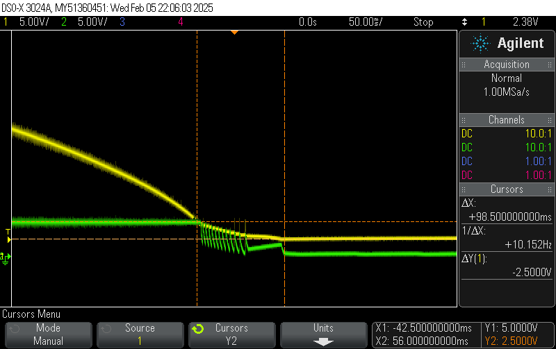

  • Hello Onkar
    Thank you for your guidance regarding the debug process. As requested, I have captured the waveforms for the following nodes:
    1. Vout (first)
    2. COMP (second)
    3. PH (third)
    Thank you
    Alex

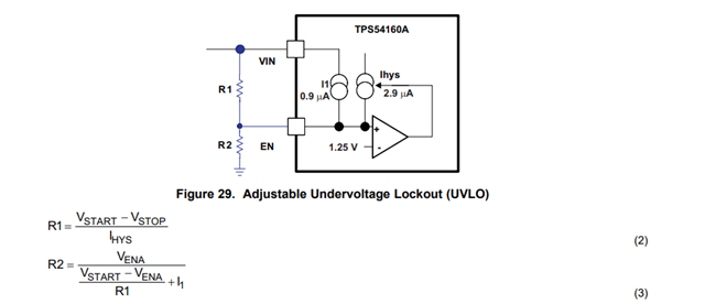

  • Hello Alex
    Thanks for sharing the waveform
    Whether this result obtained after changing components to suggested values?
    A simple solution to solve this would be to implementing Vin UVLO. You can add resistive ladder at EN as shown in picture below. Keep Vstart and Vstop voltage levels well below the minimum operating Vin in your application
    For more details, you can refer datasheet section - 8.3.9 Enable and Adjusting Undervoltage Lockout
    Let me know if need any clarification or further help on this.

    The waveforms I shared were captured using the current (non-updated) components. Some components may not be easily changed to the recommended minimum values without modifying the PCB layout.
    For example, the inductor can only be increased to 33 µH (~0.5A) while maintaining the current footprint.
    Thank you.
    Alex

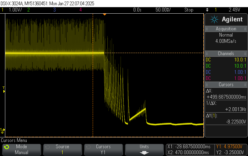

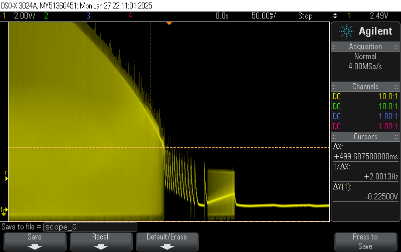

    I have captured the requested waveforms, including Vin, Vout, and BST - SW.
    Plot 1: Vin and Vout
    Below is the first set of waveforms showing Vin and Vout behavior, particularly during the oscillation event.

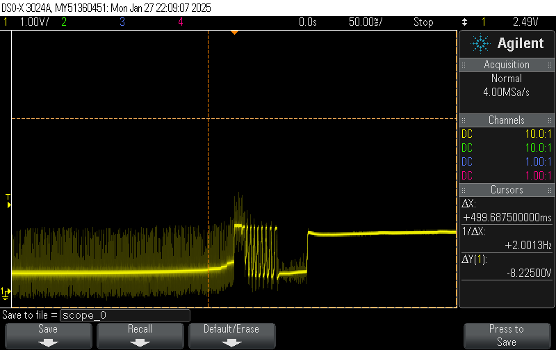

    Plot 2: BST - SW Measurement Setup
    Since I currently do not have a differential probe, I measured BST - SW using three standard oscilloscope probes:
    • Probe 1 → SW (PH) node
    • Probe 2 → BST node
    • Probe 3 → Vout (for reference)
    • Math Function: BST - SW = Probe 2 - Probe 1
    Thank you
    Alex

  • Hello Alex
    I apologies for the delay
    From waveforms it is evident that regulator is hitting boot UVLO and going through multiple ON OFF cycles before completely turned OFF.
    To avoid this scenario, I would recommend you limit Vin STOP to the level where boot UVLO starts hitting. It can be implemented by using EN hysteresis as mentioned previously on this thread.
    Let me if it resolves the issue
    Thank you
    Onkar Bhakare
  • Sorry for the long intervals between posts (as I am working in parallel on several projects).
    Following your recommendation, I prepared a resistive ladder on the EN pin with an upper resistor of 121kΩ and a bottom resistor of 18.2kΩ, achieving a Vstart of ~10V. After this change, the shutdown Vout oscillations disappeared.
