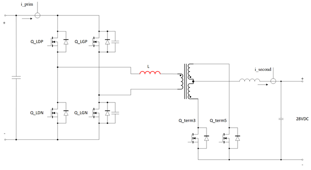

                The two MOSFETs (Q_term3 and Q_term5) are the used in the secondary side of a phase-shifted full bridge DC/DC converter. We first just try to use the two MOSFETs as diodes. So the drivers shouldn't be even working, let alone reporting fault.

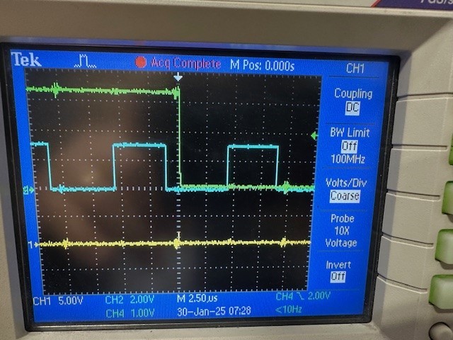

    I took the screenshot of the Vin+ to Vin-, DESAT, and FLT, as shown below. The bandwidth of the probes is 200MHz and 100MHz for the oscilloscope.
    CH1 (yellow curve) is the DESAT signal, CH2 (blue curve) is the PWM input signal, and CH4 (green curve) is the FLT signal. At the moment FLT went down to zero, PWM input is low and DESAT is also low. The peak value of the noise on DESAT signal is around 2.2V, far lower than 9V threshold. But FLT is pulled low to report a fault.

  • The waveforms of VCC (Ch2 blue curve), VOUT (Ch1, yellow curve), and FLT (Ch4, green curve) are shown in the screenshot below. When Flt happens, VOUT is low, and VCC is at 3.3V).
    The waveforms of VDD (Ch2 blue curve), VOUT (Ch1, yellow curve), and FLT (Ch4, green curve) are shown in the screenshot below. When Flt happens, VOUT is low, and VDD is at 15V).
    All shows that Desaturation fault shouldn't be generated and reported. Please help find the possible fault generating mechanism here and advise about possible solutions.

  • Hi Charlie,
    Thanks for all the screen captures and ruling out all potential FLT low scenarios.
    FLT will be low incase of the following scenarios: DESAT occurs, VCC /VDD supply disturbed and noise impacting the gnd planes.
    If it is noise induced, need to isolate the noise source. Our understanding of noise coupling path is mainly through COM and VEE, and some cases through GATE (OUH/OUTL)
    During the FLT event, I see noise coupling to all channels (assuming that it is due to some switching).
