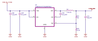

LMR50410-Q1: LMR50410Y3FQDBVRQ1
Part Number: LMR50410-Q1
we have connected the circuit as per datasheet, our input voltage is 5V which we have given through USB and that is reflecting in the input side, but for the output side we need a voltage of 3.3V, the feedback resistors are 51K and 22.1K as per the datasheet, at the 3rd pin we are getting 1.5V but output we get 5V, when we check with other supply voltages, 6V input 6V output and so on till 11V input, then till 20V input the output we get is 11V
 Please help us rectify this issue
    The device you are using is the LMR50410Y3FQDBVRQ1 and has a fixed voltage. For fixed voltage output LMR50410-Q1 device, the FB pin must be directly connected to the output point and not through a resistor ladder. If you would like to keep your resistor ladder, you would have to switch to the LMR50410YFQDBVRQ1 version of the device.
