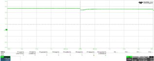

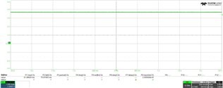

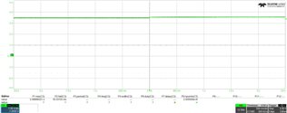

    Once again re-calibrated the gauge. The calibration process was:
    1. Connected a load to draw 1A current from a DC voltage source.
    2. Entered this 1A current value i.e. 1000mA in "Applied current" section under Calibration tab on BQ Studio.
    3. Selected "Calibrate current" and then "Calibrate Gas Gauge".
    Now, repeated the test by 2 % discharge of battery and followed by a rest time (Rest time has been 2 days due to holidays).
    Observations after 1sec pulsed load:
    1. SOH_Merit bit is set high.
    2. Current is reported as 3294mA even though my discharge current is 260mA (2% discharge).
    3. First time Measured Z value changed from -32768 mOhm to some different value i.e. -60 mOhm.
    Attached herewith are the Waveforms before, during and after 1 sec pulsed load. The waveforms are smooth and pure DC of 3.6V. Only a small obvious change in voltage is observed while turning pulsed load on/off.
    Please analyse these test results and suggest on how to proceed further. Is this value of -60mOhm promising ?

  • Hello Sudarshan,
    Sorry for taking a while to get back to you. I think the -60 is promising. Since you didn't see the EOS_BAD_OCV bit being set, I think this should be going in the right direction. Continue the testing and keep gathering data.
