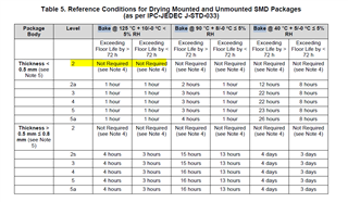

I would like to know baking condition of TPSM82901SIS and TPSM82903SIS.
it is recommended to refer to the SMD thickness of 0.34mm, In E2E below,
TPSM82903: The value of Package Body thickness for bake condition - Power management forum - Power management - TI E2E support forums
Therefore, From Table 5, I understand that baking is not necessary because 0.34 mm is a value of 0.5 mm or less.
Is it correct?
