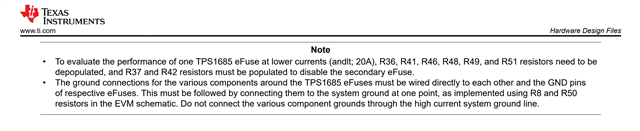

Since there are no layout files available for this design - (I'd like to get those too if they are available since I'd like to see the stack-up); and we're only allowed one order per 30 days - I want to make sure this is the procedure for enabling just one device:
Are there any additional steps?
