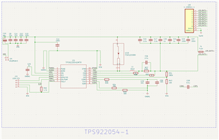

    I had a question about how the TPS922054 works. From what I understand, it is current based. I was wondering, if my Rsense is 0.05ohm, will the TPS922054 try to push 4A on its ON time or does the current vary depending on the PWM input.
    We're having issue when we connect our led bar to our system the led bar flashes once at full intensity and then becomes very dim whatever the PWM input is. My voltage drops from 55V to 34V. The led bar is rated for 48V-60V at 40W.
    Here's my schematic. Let me know if you think of anything that could cause this issue.
    Jeremy

    If the Rsense is 0.05ohm, the LED current is set as 4A. And if you choose PMW dimming, when the PWM input signal at the PWM pin turns from low to high, the internal NMOS FET starts switching and the inductor current rises to the determined value. The LED current is then regulated at the determined value as long as the PWM input signal stays high. When the PWM input signal turns from high to low, the internal FET is turned off causing the inductor current falling to zero. The internal FET maintains off and the LED current stays zero as long as the PWM input signal stays low.
    Could you pls kindly clarify the test condition when this issue happen? I am not sure if there is a case happen that VIN is 34V and LED string voltage is 48V ~ 60V (12pcs ~ 20pcs LEDs)?
    Thank you!
    BRs
    Lucia
  • When I connect the led bar to the output of the TPS922054, the voltage goes from 55V to 34V. it's a 4ft led bar with around 260 leds in series and/or parallel. they have a 2.5V forward voltage and around 40W of power altogether so around 750mA.
  • Hi Jeremy,
    From your problem description, it looks like even the ADIM is always high, PWM is always high, the LED bar will become very dim? If this is the case, could you pls first try to connect TEMP to AGND directly to disable thermal foldback? I would like to know whether the thermal protection is triggered.
    Or maybe not sure if you mean that even if the PWM is low, but LED is very dim. If this is the case, pls re-design the UVP resistor: Please do not design R_UVP1 and R_UVP2 with too small values. You can refer to this E2E thread for the reason. A rule of thumb is that you can design the sum of R_UVP1 and R_UVP2 to be around 1Mohm or 2Mohm and this normally would be a good start point.

  • Hi Lucia,
    I changed the 10K I had for a 100K on UVP and it solved my issue. Our VIN is between 48 and 60V, usually around 55V. If you have a value recommandation for R_UVP1 and R_UVP2 we're always open to making our design better! Same thing if you look at my schematic and see some values you'd change.
    Thanks for your help!
    Jeremy
