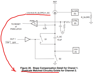

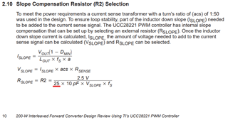

Q1. It seems that the slope compensation is 25 according to the P.4, but it seems the value is 16.6 accroding to Figure 20 as below. How should they understand this difference?
Q2.  This is similar question with below link.
https://e2e.ti.com/support/power-management-group/power-management/f/power-management-forum/540719/ucc28220-uvlo-ovlo-hysteresis-design-questions
As the figure below, the 1.26V and R4 doesn't have any affect on the circuit. And it is not clear to get equation (9). Could you clarify this confusion?
