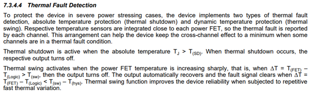

When the switch is on, a short to GND or overload condition causes overcurrent. If the overcurrent triggers either
the internal or external current-limit threshold, the fault condition is reported out. The microcontroller can handle
the overcurrent by turning off the switch. The device heats up if no actions are taken. If a thermal shutdown
occurs, the current limit is IILIM(TSD)to keep the power stressing on the power FET to a minimum. The device
automatically recovers when the fault condition is removed.

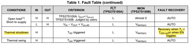

what is the fault recovery time here?
when I short circuited Vout and ground, FLT pin is going low as expected, but it not recovering even though the short circuit is removed.
why is it like this?

  • Hi Sooraj,
    We cannot guarantee a fault recovery time. Auto-recovery depends on the temperature of the device and if the fault is removed. It is possible that the temperature of the device is not low enough for auto-recovery. You can also try toggling the EN pin to see if the output comes back on without a fault condition. Please see below.

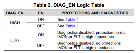

  • Hi Sooraj,
    The maximum recommended voltage that should be on the FLT pin is 5V as it is pulled high during normal condition and low when a fault occurs. The fault pin can be pulled up to 5V by the LDO If you are using the EVM or an external power supply.
    Since the open load protection is part of diagnostics, the only way to disable it would be to turn off the DIAG_EN pin which would remove all of the protections (please see the fault table and below for all of these features).

  • Hi Sooraj,
    I apologize for the confusion, so disabling diagnostics would make it so faults are not being reported. The current limit and thermal shutdown/swing would still be active. You can use the B version of the TPS27S100 device and make sure to NOT connect an external pull-up resistor from the output to the power supply, so that off-state open-load detection is not available. During the on-state, the user judges if there is an open-load condition. Let me know if you have any more questions.
