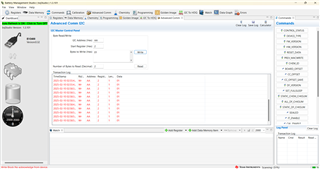

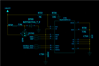

I am trying to configure the BQ34Z100 using the EV2400. When I enable continuous scanning, the error message "No acknowledge from the device" appears.
1. The device is connected to PORT2 via I2C.
2. The EV2400 is detected in the device Manager under the Human Interface Devices section as a USB input device.
