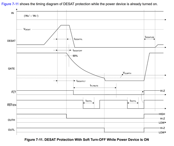

I asked the DESAT question for UCC21750 in previous E2e thread.
https://e2e.ti.com/support/power-management-group/power-management/f/power-management-forum/1452007/ucc21750-does-the-desat-feature-need-the-non-100-duty-operation-to-trigger
our customer wants to know why the following DESAT protection case noted in datasheet can work without leading edge blanking time, t_DESATLEB?
They also try with the EVM board to reproduce the DESAT protection with soft turn-off while power device is ON.
but they can't observe the DESAT pin starting to charge the C_BLK and increase the pin voltage level to threshold 9V.
could you please provide some possible reasons and hint?
best regards,
Hank Lin

    our customer wants to know why the following DESAT protection case noted in datasheet can work without leading edge blanking time, t_DESATLEB? -> can you please elaborate this question? Do you mean that "leading edge blanking time, t_DESATLEB" is applicable ? Yes leading edge blanking time, t_DESATLEB is applicable.
    Can you please share the waveforms captured close to DESAT pin, INP, OUT and FLT pin?
    So that we can understand the issue.
    Sasi
  • Dear Sasi,
    please refer to my answer
    can you please elaborate this question? Do you mean that "leading edge blanking time, t_DESATLEB" is applicable ?  yes that is what I mean.
    I'm requiring customer to share the waveform. please wait, thanks!!!
    Hank Lin
  • Thanks Hank for the confirmation.
    Yes, t_DESATLEB is applicable to UCC21750 devices.
    We are looking forward for the customer waveform.
    Sasi
