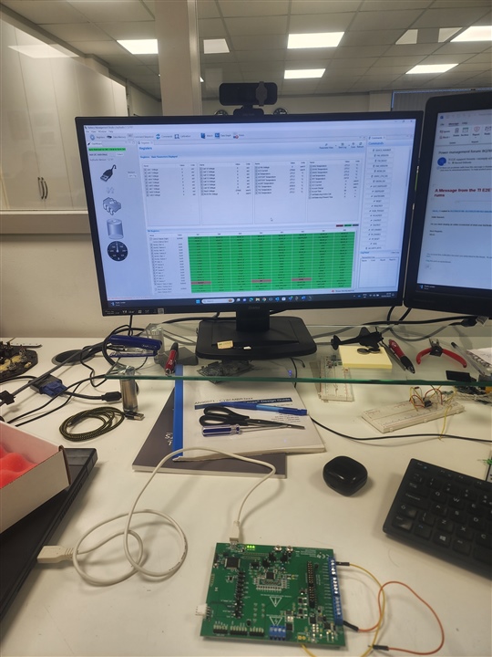

  • Hello Alexis,
                        Please find both the screeshot of the BQ Studio when the EVM board is connected as well as the setup.

  • Hello Naveed,
    Do you have the shunts connected at J15 and J18 as well when you’re trying to use the EV2400 to communicate with the board to your computer/laptop? It's weird for the USB adapter to not work if it is connected as shown in Figure 2-1. EVM Connection for Basic Operation from the EVM User Guide.
    Also, I noticed from your image, that it says 'No free adapters are available for use on this system' on the bottom left corner. Please try following this post to see if that also helps.

  • Hello Naveed,
    Something like the below must be detected.
    What does your setup look like? Show a picture of your set up.
    Are you using on board EV2400 or external EV2400?
