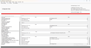

Hi TI team,
As title, I tried to use customization tool to disable all of the values for interrupt mask for I2C1 & I2C2 but also failed, but IO Config setting Pin Multiplexed to GPIO and Disable was OK. please help to check the pjt file, thanks.
 x58_0207.pjt

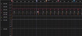

  • Results:
    I have used the PJT and the FW provided and could NOT reproduce the results.
    Setup:
    I used the provided PJT and the FW Base Image they provided and loaded both onto a TPS65994BH EVM. I used a Saleae Logic Analyzer to gather the logs and monitor the device boot and signals.
    I have the following signals probed: I2C1_IRQ, I2C2_IRQ, LDO_3V3, I2C1_SCL, I2C1_SDA
    Analysis:
    I started with the EVM powered down and began the Saleae capture (attached). I then provided power from VSYS as if system was booting up not from PD.
    Here is LDO_3V3 going HIGH along with the IRQ signals.
    I confirmed the PJT was loaded because I see APP mode in the I2C log:
    Confirmed also by reading Customer Use register which matches the PJT:
    Confirmed the FW Base Image is F909.12.15:
    Throughout these reads and tests, the IRQ was HIGH all the time.
    Conclusion:
    There is a potential hardware issue happening here and not a PD firmware bug. Other potential (less likely) issues could be that or there is a valid reason for asserting the I2C1_IRQ, Another device is pulling the I2C1_IRQ low (other PD controller maybe?), Incorrect signal is being probed.
    Chris

  • Hi Chris,
    It's not a hardware issue, the IO Config setting Pin Multiplexed to GPIO and Disable was OK. the interrupt pin was always high. Here is the pjt file which setting GPIO10 disable, please help to check. x580_TBT5_F909p12p15_30DA_v3118_20250217.pjt
