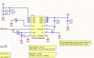

I wanted to ask if there is a way to disable the current limit mode while still keeping the slew rate control and short-circuit protection.
Specifically, can I set IL to ground to prevent the current limit protection from being used? If so, I assume I could then set the ILTIMER pin to any desired value, such as VCC.
My goal is to use the device as a load switch with slew rate control but without the current limit—only maintaining the short-circuit protection.
