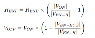

  2. Modified UVLO Calculation for Negative Power Supply
    • Based on our understanding, the calculation should account for the absolute values of V_ON and V_EN-H to ensure proper resistor divider operation.
    • We derived the following modified formula for negative voltage UVLO:
    • Could you confirm if this adjustment is correct for a negative power supply application?
  • Can the UVLO resistor calculation from the datasheet be directly applied to negative power supply designs?
  • If not, could you provide the correct formula or recommended approach for UVLO configuration in a negative voltage system?

  • Hello
    The equations in the data sheet would not apply to the IBB.
    Adding UVLO to the IBB is a little tricky.

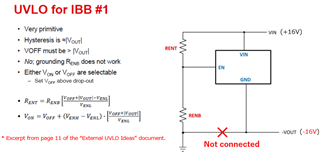

  • Hi Frank,
    I would like to delay the output timing of "-VOUT" relative to "VIN." Do you have any recommendations or suggested circuit configurations to achieve this?
    Under our current conditions, the recommended input voltage range for the enable pin is -16V to 0V. Given this, I believe the circuit configuration shown below is not recommended, correct? On our custom board, RENB is connected to the board’s GND (0V) as illustrated in the diagram below.
    We have confirmed through experiments that adjusting the resistance values of RENT and RENB allows us to delay the "-VOUT" output. However, we would appreciate your expert advice on whether this approach is appropriate and if there are better alternatives.

  • Hello
    I think that any of the suggestions for IBB in the document I provided should work.
    Connecting RENB to -Vout is the correct configuration.

  • Hello
    The important voltage ratings are specified between a pin and the PGND/AGND pin of the regulator.
    For both the LMR33640 and the LMR33620 the maximum allowable voltage between the EN pin and PGND/AGND is 38V.
    While the maximum recommended voltage is 36V.  So, in figure 8-1 that you show from the document, the voltage between EN and
    PGND/AGND is 12V+5V = 17V.  That is safe.
    In your case, if you connected the EN pin to the VIN pin, the voltage between the EN pin and the AGND/PGND would be 16V+16V = 32V.
    That is safe.
