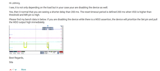

I have a futther question about TPS3851 as discussed below:
https://e2e.ti.com/support/power-management-group/power-management/f/power-management-forum/1378892/tps3851-q1-confirmation-about-the-reset-timeout-period-trst-in-wdo-pin/5268322#5268322
could you provide the more detailed time about the 'immediately' shown in the discussion.
thank you
  • Hi Johnny,
    The "immediately" when the device is disabled is the propagation time from the device being disabled to the WDO going to high (unactive) state. This time is not classified in the device datasheet but judging from Sila's lab capture is less than 1ms.
    Joshua
