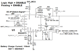

Hi TI Team,
I am encountering an issue with the BQ24073 Li-ion battery management IC when trying to reset an active PCM (Protection Circuit Module) on a Li-ion battery. Here are the observations:
  1. Setup Details:
    • The PCM activates due to low battery voltage (below 3V) and disables the battery output (0V).
    • During power-up, I observe a transient voltage rise from 0V to 3.5V on the BAT and BAT1 pins for ~200ms.

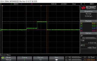

  2. Current Measurement:
    • Using a 10Ω resistor in series with the battery, I measured:
      • 156mV drop (15.6mA) for 28ms.
      • 662mV drop (66.2mA) for 25ms.
  3. Additional Observation:

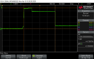

  • Hi Garrett,
    Thanks for getting back to me!
    More Findings on PCM Wake-Up Behaviour:
    I've noticed that the PCM wake-up issue mostly happens when the battery is slowly discharged with a low current. In these cases:
    • After a slow discharge, the battery voltage stays low when the PCM kicks in, and the BQ24073’s transient pulse (53ms - 100ms) doesn’t seem long enough to bring it back to life.
    • If I apply 3.6V, some batteries take around 40 seconds to wake up—starting at 12mA before jumping to 60mA when fully active.
    • If I apply 4.3V, the wake-up time is much shorter (~5 seconds).
    • The HiMax(battery) datasheet doesn’t specify how long voltage needs to be applied, only that it must be above 3V.
      Also,
    • When the battery is discharged with a higher current, its voltage drops more significantly under load. But once the PCM activates, the battery cell voltage rebounds slightly (since there’s no longer a load).
    • In these cases, the BQ24073 wakes up the battery just fine, and everything works as expected.

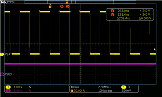

    When BQ24073 initially measures 0V at bat pin it will perform battery detection procedure where is provides approx. 7.5mA current to BAT pin for 250ms. This is shown in waveform below as well as figure 10-3 in the datasheet.
    One way to prevent this battery detection procedure from being performed is connecting TD pin to logic high. Can you please check if this works to close your protection circuit? Other than changing status of TD pin there is no way to extend the on time (approx. 250ms) for battery detection when BQ24073 IC initially measures 0V at BAT.
    Garrett
