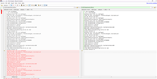

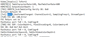

When connecting to a laptop, there is a problem of slow image output. Upon investigation, it was found that the switch and the KTM5000 DP to TMDS chip in the backend have undergone multiple handshakes. The USB 3.0 signal in the backend passes through a HUB chip, which does not experience multiple handshakes when using 5G firmware. However, when using 10G firmware, multiple handshakes occur, resulting in a long image output time. So, will the 10G signal of USB 3.0 affect the DP signal? And possible reasons for slow image production.
a. Hardware design framework:
b.  On the left is the slow image output of HUB using 10G firmware, while on the right is the fast image output of HUB using 5G firmware.

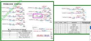

c. schematic diagram.
