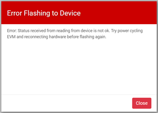

First of all we are having issue flashing the board with the GUI, we recieve this message constantly. We belive it is because the TPS25751 is not recieveing P3V3 correctly, we could not find in the board The supposed LDO U11 that powers this line but we belive that is not working.
We removed J13 and provided 3V3 to VIN_3V3 externally and we got to flash the device from some computers, in others the same error flashing device notification pops up when reaching to 70%. We saw that other users had the same problem so altough this is an issue for us we are ignoring it for the moment.

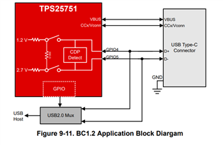

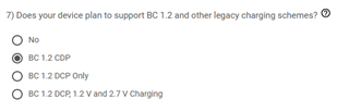

After succesfully flashing the device we connected the tablet to the EVM and it looks like it is charging correctly but the EVM does not provide any way to check that communication role it is also configured as desired as the data lines are literally stubs in the default configuration with R32 and R33 not mounted. Do you have any recommendation on how to test this? We were planning to solder some cables to the data lines and take them into another system but we would like to avoid this type of reworks if possible
