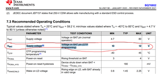

    I noticed this max requirement of 12V on the BAT pin during OTP. I don't know how one could ensure that? Our board is designed for a 13P configuration and it'll go up to 54V at the least, during OTP. Please advise if I understood this incorrectly.

    Please follow Section 3 OTP Programming from the Calibration and OTP Programming Guide we have.
