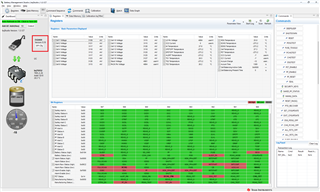

This topic has been covered numerous times, but I am not having success getting it to work:
When the bq76952 and bq34z100 share an I2C bus, bqStudio wants to open the bq34z100 and that leads to issues communicating with the bq76952.
I've followed the steps below several times, but bqStudio still has the bq76952 showing up at address 0xAA and I am getting corrupt data.
Cell voltages are reporting incorrectly and the Data Memory cannot be written to.
Eventually I get a "No acknowledge from device." message in the bottom left corner.

  • Hi Kevin,
    Why does it say SPI in bqStudio? Are you using SPI communication?
    Are you able to talk to the BQ76952 at all? Not even if using this device alone?
    There's no other solution than using two instances. These two devices should have different I2C device addresses, so they should not really be fighting on the I2C bus.
  • No I'm not using SPI. This is just how it comes up in bqStudio.
     That SPI Config is always there.
    If even shows that window if you look at the images in the bq76952 Evaluation Module set up guide.
    I am able to communicate with the bq76952 with the bq34z100 completely removed.
    However, it comes up showing I2C CRC communication.
    I have to use the SWAP_TO_I2C Command to get it read Data Memory properly.

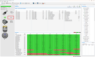

  • You'll see in the picture that I've boxed in the area that always shows SPI.
    So far it seems to working, but I will need to figure out why having the bq34z100 on the same bus, even though it has the a different address, is causing problems.
    Kevin
  • I'm also curious as to why the bq76952 is defaulting to I2CCRC communication.
    That could be part of my issue.  As I mentioned, I have use the SWAP_TO_I2C Command to do any of value with the Data Memory values.
    Kevin
  • I figured out the I2CCRC thing.  The part I'm using is the bq7695202, which has CRC enabled.
