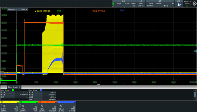

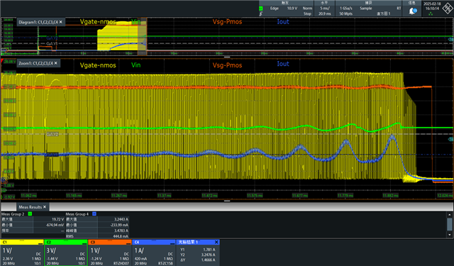

    Another app problem when customers tried use TPS92692-Q1 EVM to achieve buck-boost, they have adjusted the external components parameters as inputs in the calculator file of attachments. (Some parameters slightly different as recommended in excel: Vin=13.5V,Vout=27V,  IADJ=1V,Ccomp=15nF(no other parallel capacitors), Tsl=510K, L=25uh,Rcs=0.04Ω;Ris=0.013Ω).
    They found that when Iadj voltage is around 1V, the output is unstable and they have caught the waveform of PFET/NFET/Vin/Iout as in below figure. It seemed that some protection is triggered while the NFET and PFET are turned off. However, when customers declining the slope resistance to 220kohm and increase the Ccomp to 182nF the device can work normally.
    Pls give some suggestions on what could possible cause this and if it is recommended to adjust the slope resistors and compensation capacitors, because it seemed far away from the recommended value, thanks.

     Also, at low line (8Vin) you are sending a ton of current through your circuit.... assuming 90% efficiency (which is generous given expected losses due to the large current), you're probably looking at around 15 Amps at the input. This is my first concern, our device is only rated to 125 °C and I don't know what environment your customer expects this device to operate in, but you can expect the PCB to get extremely hot purely due to that power dissipation. Your customer will have to do a very good job at optimizing thermals in order to prevent our device from failing and they will likely have to use very large FETs to accommodate the power specifications. The issue with using large FETs is that the FET driver in our device is not made to drive large FETs so your customer will likely have to use an external FET driver.  We do not recommend operating our device under these conditions because I believe this will be very hard to achieve without failure.
    Regarding the CCM-DCM boundary condition, are you saying that given the 80uF inductor, you will be in CCM above 2W out of 105W? If this is the case, that is a great margin.
    Onto your second issue... Based on the wave forms you provided, I think you will have to adjust your compensation network as this looks like some sort of instability which may be  the cause of the oscillations you see. I really need the schematic to give you more thorough feedback, but make sure your bandwidth for your compensation network isn't too wide or else the circuit will take too long to respond and will oscillate. I also want to see if any faults are being triggered which will help me figure out why your device is turning off.
