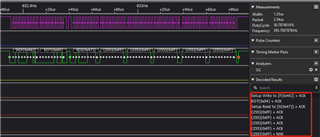

    1. About "When you say you can't access I2C registers, is the I2C address not acking at all?"
    [Adam] -- No, the I2C address (write & read operations) is ack-ed right. For example, as below, to read register 0x04, the ack-s for I2C address-write, register number and address-read are correct, but PD controller doesn't respond the right "Byte Count".
    More details about I2C wave captures, please refer to attachment I2C1_debug.docx .

  • Hi Adam,
    I'm still a bit confused by the logs you captured.
    In step 3, it is sweeping through all the addresses and acking on address 0x46? Which I2C line are you checking? The doc says I2C1, but you should only expect 0x20, 0x21, 0x22, or 0x23 on this port, never 0x46?
    You mentioned that you are updating the config on the EEPROM and it appears to be working properly? Is this correct?
    Are you able to negotiate PD contracts as source/sink?
    Can you share your latest project so I can take a look?

  • Hi Chris,
    Firstly, we've found out the root cause of I2C problem. It's a hardware compatibility issue. We've solved now.
    Secondly, about I2C address "0x46" problem, it's 8 bit address, 0x23 << 1 = 0x46. Sorry about that I didn't write it clearly.
