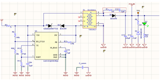

Dear TI Support,
I used the LM5181 IC in order to produce an isolated power supply with the following characteristcs: Vin = 12 V [9 - 13 V], Vout = 3.6 V, Imax  = 600 mA.

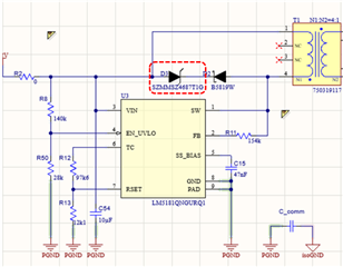

Here you can see my schematic:
The output voltage that I measure on TP2 in 1.6 V instead of 3.6 V and the switching frequency that I measure on the SW pin is 122 kHz.
Do you have any suggestion in order to have a correct output voltage?
Thank you for you support,
Stefano
