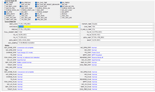

Need help in setting up BQStudio registers for 8S Lithium Ion Battery with 24V 3A Charger. The charger does not start with the values I have set.

    i have set VAC_DPM to 40320 mV but on multimeter it is showing 30.065V on the battery side and CHARGE_STAT as Fast Charging (CC Mode)  The power supply connected is showing 24V and 0.002A

  • Hello Aseem,
    Thanks for the new information. Just to clarify, you are reading 30V on the battery and 24V on VAC? Do you have a battery attached to VBAT?
    I'm reading through the registers and this looks like normal behavior for a BQ25756 in VAC_DPM so far. The BQ25756 is in fast charge mode, but the BQ25756 should not be providing current to the battery while in VAC_DPM.

    I have done the prototyping and has the final issues in the register settings. Total Battery Voltage is 26.139V for 8S. Resistors installed are 249K and 12K with setting as 1546mV.  Charging voltage adaptor connected is 24V 3A. Still not charging. The registers I have set are as follows:

  • Hello Aseem,
    I'm looking through your registers and it looks like the charger is outputting a BAT_OVP flag. I've got a few test questions:
    • Can you measure the VBAT voltage near the BQ25756 with an oscilloscope?
    • Can the BQ25756 charge the battery when the battery is a lower voltage?
    • If possible, can you measure the FB pin with an oscilloscope? Make sure to power down the BQ25756 before you put the oscilloscope probes on the FB pin.
