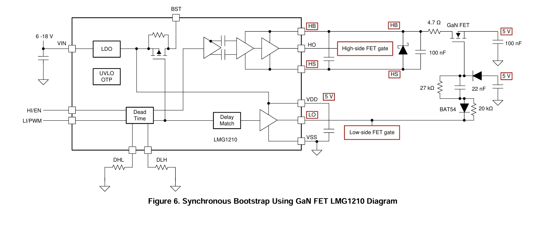

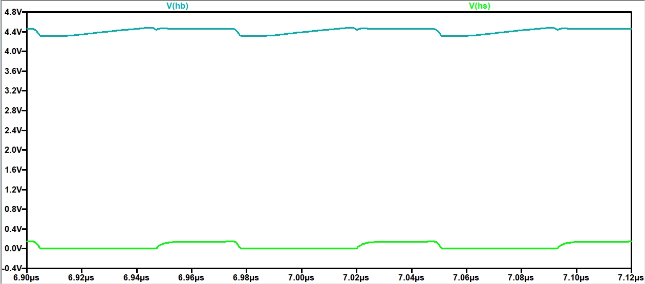

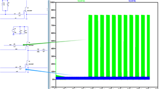

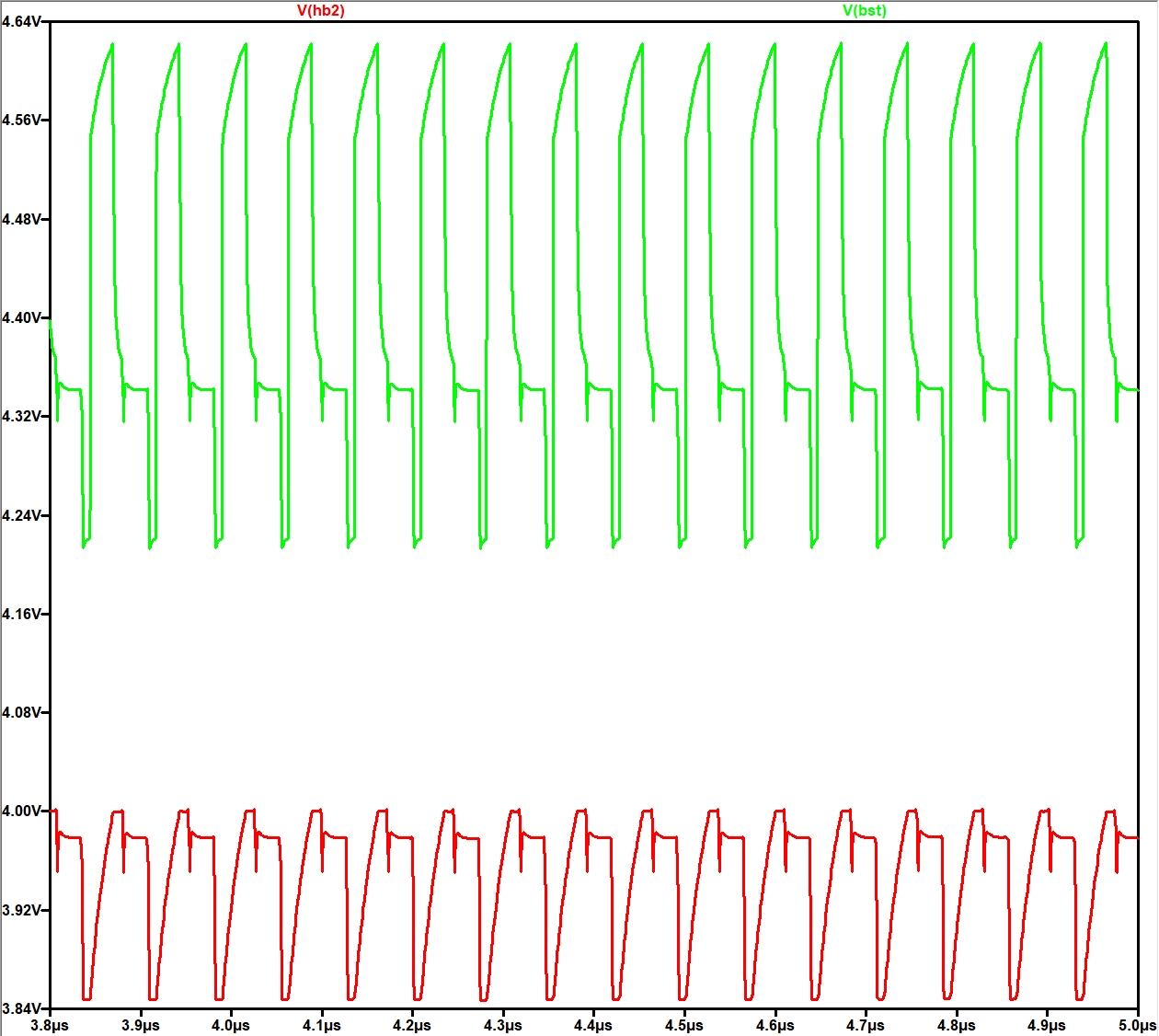

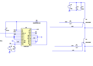

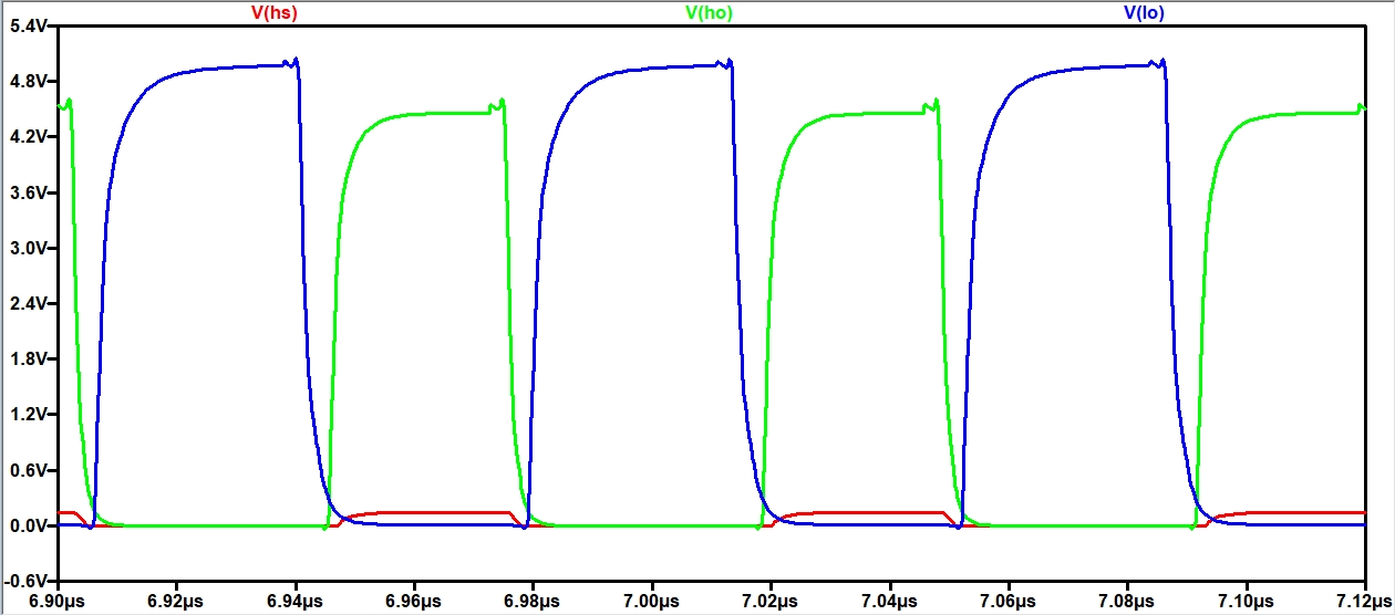

Hello Engineer, I have problem with operating  the lmg1210. First ,I can't run the simulation correctly. belows are the waveforms of HG and LG. And there are two circuits, one is Synchronous Bootstrap, another is normal bootstrap.As you can see, the Normal Boostrap circuit didn't work well.(which is the same as the first real design's operation waveform). I don't kown how to solve it. can you help me
