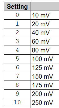

    I have a few recommendations for settings to change.
    First, Since the max current is 40A, they should change the Curr Gain and CC1 Gain to 196. The default value of 241 makes it so that the device can only measure a maximum of ~32A through the 1mOhm sense resistor. By changing the gain to 196, the LSB (a.k.a. userA) will change from ~1mA to ~1.223mA.
    Next, the current protections would need to be changed. 40A through the 1mOhm sense resistor is 40mV, so the OCD protection should be increased to match. Overcurrent in Discharge 1 Protection Threshold = 21 will set the protection to trigger at ~42A, which affords them a little overhead on their expected current.
    Lastly, the SCD protection needs to also be increased. They should set Short Circuit in Discharge Protection Threshold = 3 or more so that it triggers at a voltage greater than 40mV.

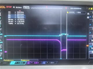

  • Hi Maxwell,
    Indeed, the supply is pull down to gnd nearly. How to solve the issue by configuring related registers?
    Blue: output current;
    Pink: supply voltage
  • Hi Beida,
    This is basically a short circuit of the battery. The load is pulling more current than the battery can supply, so the battery voltage crashes. All batteries behave in a similar manner under a load that exceeds their supply current.
    The SCD protection of our part should turn off the FETs to prevent this from happening for too long, however it seems that this is occurring at a current much lower than the customer expects.
    There isn't a setting to change to increase the current at which this behavior happens, this is a limitation of the battery itself.
