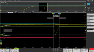

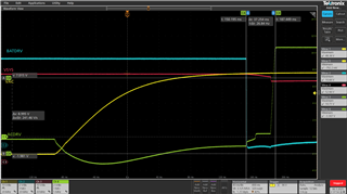

<Test setup>
VAC : Power supply 48V
VBAT : Battery (48V~58Vmax)
VAC_UV_level : 45V (HW resistor setting)
Disable Reverse mode
- The purpose of this test is to find auto-reverse voltage level to minimize the voltage dip when VAC is turned off and VBAT is switched on with 1A load condition. So I set the UV level is 45V.
But in this case, the charger doesn't charge and raises the VAC_DPM flag. so I set the UV level is 36V, It can charge.
Q1. What is the VAC_DPM HW level? it was register default set(4.2V).
Q2. Why is the charger raises the VAC_DPM flag not VAC_UV?
Q3. I want to minimize(t_Vdip) the voltage dip when changing VAC to VBAT with 1A system load. As attahc figure, the voltage level touched 10V. This may trigger under-voltage protection in connected systems.
Do you have any idea for that?
Left : VAC(48V) --> VBAT(55V)
Right : VBAT(55V) --> VAC(48V)
- load is 50W(1A condition)
Thank you in advance.

    To clarify the question, I have two problems.
    1. When I set 45V UV level, Charger doesn't charge due to input voltage regulation.
    2. How to reduce voltage dip when source changes from battery to VAC.
    (the case of VAC to battery, may be handle with UV level up as possible.)
    - Vout : 7.6V touch
    - Source changing time : 12.5ms
    - I meausred that the IC always has delay 4ms after VBAT FET and than turn on the VAC FET.
    - 4ms delay makes voltage dip at the system load condition.
    Thank you.
  • Hello Ben,
    Thanks for the new information and the new tests.
    That makes sense. I just remembered that the charger is probably in VAC_DPM here. The ACUV_DPM will be about 10% higher than the ACUV setting. We have more information in this FAQ here.
    2. For this oscilloscope capture, does VOUT=VSYS here? If you are using auto reverse mode, you could add more capacitance to VSYS. Could you also try to capture the registers after VSYS transitions to being powered from VBAT?
    Ethan Galloway

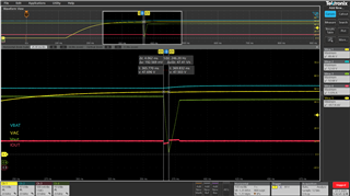

  • Hello Ethan
    I test more the Auto-reverse mode.
    When I set VSYS_REV = 48V, EN_AUTO_REV = 1, the charger generate VSYS(48V) from VBAT(52V) at EN_REV = 1(automatically).
    At that time, I turn on VAC source, measured voltage wave.
    Registers
    Voltage dip is reduce 24V(before 7V) at 1A load condition, but not enough.
    Thank you.

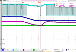

    I also quickly measured how far VSYS would dip in the lab on a BQ25750EVM with auto reverse mode enabled. In the below image:
    • VIN = 48V
    • VBAT = 48V
    • Battery Charge current = 2A.
    • VSYS_REV = 46V
    • ISYS Load = 1A
    • ACUV = 40V
    • ACUV_DPM = 44V
    • C39 and C7 were removed. Both of these caps were 56µF.
    • I would recommend removing the BATFETs before attempting this on an EVM.
    VSYS drops down to about 39V before coming up again.

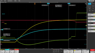

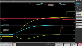

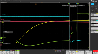

  • Hello Ethan,
    1. VAC_DPM
    - I understood, the charger will use the highest value for VAC_DPM so, It can not disable HW level internally.
    2. VSYS transition
    - For more clearly, I miss VSYS REV level setting at the first test(VSYS level is 5V) . It was IC default 5V, so that I measured 5V.
    - Additionally, I measured both of case, [0A load] and [1A load]. No registor setting, only default IC status. (auto reverse mode disabled)
    [0A load] : ACUV & ACDRV / [1A load : ACUV & ACDRV ]
    [0A load] : BATDRV & ACDRV / [1A load : BATDRV & ACDRV ]

      • I agree with capacitance helps to reduce drop. But, I can add lots of capacitor. It's not practical. (In/Out current rush)
    • Can you make sure there's nothing in your layout or schematic that would delay the ACUV signal?
      • My layout has very short cut to VSYS from VAC and VBAT even than your EVM.
      • Also I'm sure ACUV signal doesn't have delay as above measurement result.

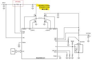

  • Hello Ethan,

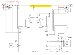

    I have a question about the IC concept.
    BQ25750 has direct power path form VAC to VSYS under the figure.
    Therefore, the IC switches the path from the battery to AC when VAC is supplied, which naturally creates the voltage dip than other way.
    Q1. What is benefit has direct power path?
    Q2. Is it possible for the MCU to hold BATFET 'on' and turn ACFET on simultaneously? (even it has different voltage level)
    Do you recommend another charger IC to avoid this issue?
    Thank you.

    How can you quickly set the transition time?
    I'm not quite sure. Can you measure SW1 to see when the charger stops switching?
    This is a very broad question. Can you be more specific in this question? In general, a direct power path allows for faster battery charging current than other power path configurations.
    This is not possible. This would cause a shoot through current from VAC directly into the battery. This would likely destroy the circuit.

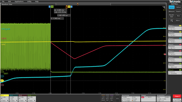

  • Hello Ethan
    I measured SW1 and VAC gate together. It takes 2.4ms for SW1 to stop and VAC gate to turn on.
     - Auto-reverse mode
     - VSYS_REV : 48V
     - VSYS load : 1A
     - VAC : 48V
    Thank you.

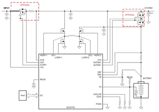

  • Hello Ethan
    I have a idea for BQ25750 application.
    If I use a single FET at ACFET (without Back-to-Back concept), It might be reduced voltage drop because it supply immediately when pluged into the VAC.
    Is this a possible application to BQ25750?
    Thank you.
  • Hello Ben,
    Once again, thanks for being patient with the wait.
    Yes, you can use a single FET for the ACFET. Keep in mind that current will be able to flow through the body diode from VAC to VSYS.
    I'm looking at your previous waveforms and I think the ACFET is turning OFF and ON because of the 8A limit switchover limit. This might be I have a few suggestions to help with this:
    1. Short across the RAC sense resistor. This will disable the 8A limit through the ACFET.
      1. You can also reduce the resistance of the RAC sense resistor as well.
    2. Using 1 FET for the ACFET would work if your system allows for it. Power would flow through the FET and power VSYS while the FET is turning ON. You should make sure there's no scenario where current can flow from VAC into the battery though.
    Let me know if either of those methods will work for your system and let me know if those methods improve the VBAT to VAC switchover time.
    Ethan Galloway
  • ddddddHello Ethan
    I tested after RAC sense resistor short. It looks working well without voltage dip but, sometimes measured.
    If RAC sense resistor short, BQ25750 doesn't know IAC right?
    I think the 'VBAT < VAC' condition may not guarantee normal operation. When VAC connects, it appears as a short-circuit from the external DC adapter's perspective. So this way cannot be used.
    Thank you.
  • Hello Ben,
    Yes, this is correct. Will not having this function work for the system? If you were using the IAC_DPM function to limit the power, could your system instead use ACUV_DPM to limit the power?
    I think you are correct about this.
    Ethan Galloway
