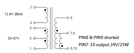

I am trying to design the TPS23731 in a system that will generate 24V on the output. I do not see many reference designs online and for whatever reason I am unable to download the P-Spice simulation tool on the website. Is there anyway you could send this to me via email or allow me to download it? Or is there another reference I can look at?

    Please find attached schematic & BOM that changes PMP22806 from 12V output to 24V output.  LDT1069-50R may be considered to change wire to become 24V out from 12V out. Let me know if you need additional information.

  • Hello, I have made these modifications, but I am seeing the voltage drift up to ~36V with no load. In our design we are using this transformer: 750314782.
  • Hi Michael,
    TPS23731 uses primary side regulation. This method will have a less accuracy load regulation compared to secondary side regulation. At open load, the Vout will normally higher than desired Vout. Meanwhile the inductance is 37 µH which causes DCM, which is worse for primary side regulation.
    1. It is recommended to use transformer with higher mutual inductance.
    2. Primary side regulation needs AUX and SEC windings having a better coupling coefficient than secondary side regulation
    3. If at a light load Vout can drop to ~24V, you may consider adding a dummy load with a Zener diode
    Diang
