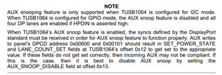

I'm trying to support Pin Assignment E by GPIO control on my custom board.
The DP sink device which I use can swap lanes and invert the polarity of ML and AUX.

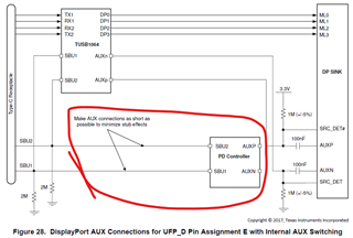

My custom board is similar to the Figure 28 on the datasheet, but I don't connect SBU lines to PD controller.
 I tested but I couldn't display the signal with Pin Assignment E in this case.

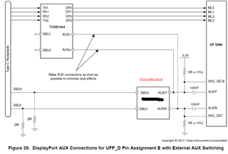

But after I changed SBU connection like the Figure 29, I could display the signal with Pin Assignment E.
I prefer to use Figure 28 circuit because I'd like to reduce ICs.
Question
How can I display the signal with Figure 28 connection?  Why PD controller is connected to SBU lines?
