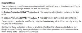

    Then I want to ask, does DDSG always follow the DSG level signal. If the short circuit protection is triggered, can DDSG switch over immediately (for example, after the short circuit protection is triggered, DSG outputs 0, can DDSG output 0 immediately)? Is the protection time consistent? (Because it is after the short circuit protection is triggered, I use DDSG to cut off the MOS)
    I am now referring to this manual Application Note Using Low-Side FET in BQ769x2 Battery Monitor Series.
  • Hello L,
    The DDSG when configured as DDSG function, should follow the DSG FET driver state.
    In regard to the timing, please refer to the section below found in the ‘Do the DCHG and DDSG Signals on the BQ769x2 follow the CHG and DSG FET driver pin states? FAQ’:
    Alexis
