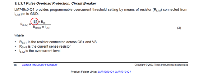

Hi Expert,
Have a good day.

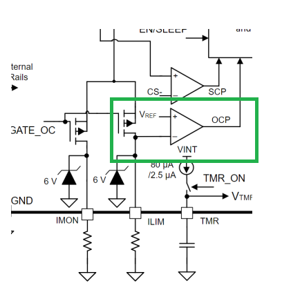

Could you help to explain what “12” in Equation (3) mean? It seems a voltage value?
And why this could be used to calculate OCP threshold?
Thanks!

Hi Leo,
This comes from an internal spec.
Shiven Dhir
Hi Shiven,
Thanks for reply.
Sorry I am still confused.
This value is 1.22V, why in the equation is 12?
And how to understand the 12* RSET?
Best Wishes,
Leo Ma
Hi Leo,
1.22 has been rounded off to 1.2. While deriving the equation, it becomes 12.
This will help you understand the derivation.
Shiven Dhir
