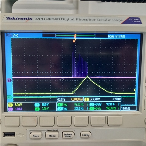

    We have additional question with respect to below observation:
    Condition: System is OFF and nothing is connected on the BQ25750EVM (no VAC/no VBAT). When we connect the Battery on VBAT, the charger fails to start and reboots continuously.
    Above capture shows SYSTEM voltage (yellow) and SYSTEM current (purple) when the issue appears.
    It seems that adding a 10 nF capacitor between BATSRC and BATDRV fixes the problem. We would like to understand the technical rationale behind this. If capacitor is necessary, any recommendation on the value to choose? Do we have to add resistor in serie also?
    What's your battery voltage here? If you connect a DC voltage to VBAT, does it show the same behavior?
    We recommend a 10nF capacitor to slow down the BATFET turn-ON and turn-OFF time when the battery is above 30V. This protects the charger from damage from battery hot-plugs.
    If you are going to use auto-reverse mode, you can remove the BATFETs. When the BATFETs are removed, connect BATSRC to SRP and leave BATDRV floating.
