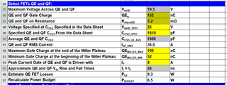

Q2. Regarding Formula (61)
Based on Formula (61), VdsQE should be 39V, but in the diagram you previously provided, it is shown as 19.5V.
Could you explain how 19.5V was calculated?

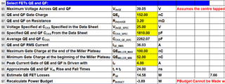

Q3. Regarding Coss_qe_avg in the diagram
In the diagram mentioned in Q2, Coss_qe_avg is shown as 2262.07 pF.
I believe this value may have been calculated using Formula (64) where the numerator and denominator are reversed incorrectly.
Could you kindly verify this calculation?

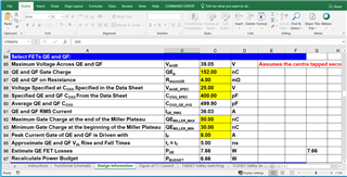

Q4. Regarding PBUDGET calculation error
When I perform an automatic calculation using the parameters provided in the application note, PBUDGET becomes negative, and an error occurs.
Therefore, I suspect that there may be a mistake either in the application note itself or in the provided Excel design tool.
Could you please check this issue in detail?
