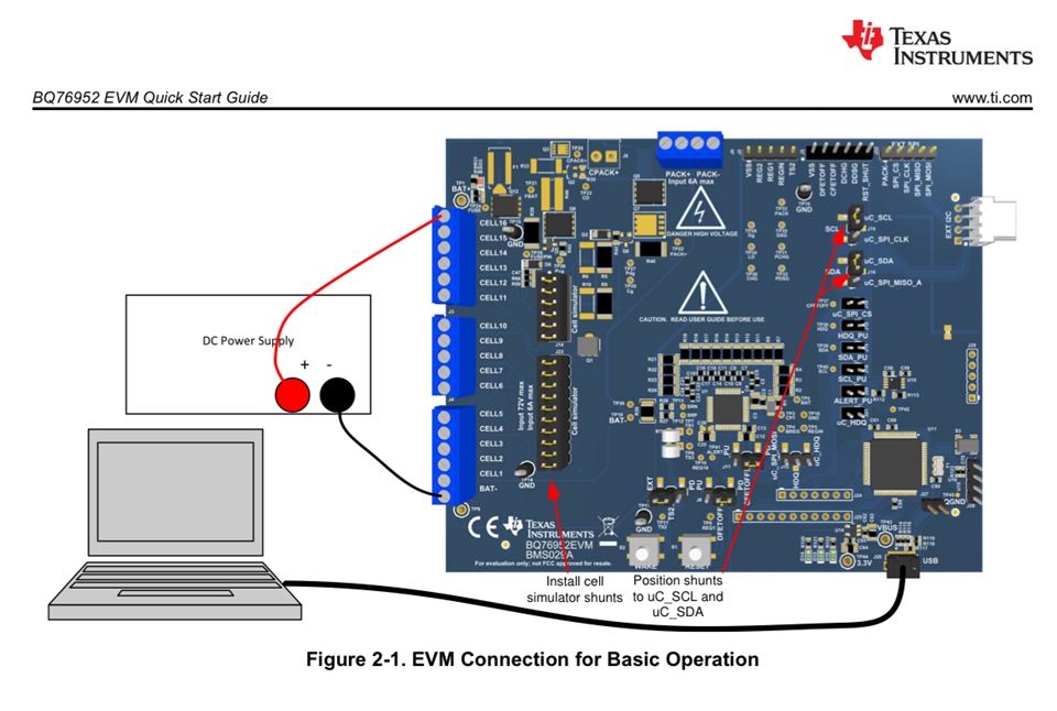

I read the EVM user manual which says that I can test the module by connecting the DC supply between bat- and V16, however, I do not have the EVM module. Can I still do this without the EVM and how can I achieve a way to test 6s with a DC power supply.

  • Hi Alexis!! Im sorry for the confusion I am not the best with explaining things. I wanted to know how I can test the IC without batteries and only using a DC power supply. I saw that on the EVM module the dc power supply was connected to Bat+ and VSS which makes sense, I just wanted to know if I could do the same with the IC itself. If there are no batteries connected to the IC and I am using the DC supply to simulate the overall BAT+ and BAT- power, how would I connect this? I am sure its a lot easier than I am thinking however I want to make sure I dont damage the chip, thank you!

    Thank you for clarifying. You can just use a power supply without actual batteries to test the EVM. However, if you are not planning on using the EVM itself, and want to test with a power supply, you would want resistors in place to 'simulate' the number of batteries you want expect your system to have. Please refer to Figure 5-10. Schematic Diagram Pin Configuration from the EVM User Guide and refer to the 'Cell Simulator' on the right side.
