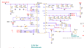

HI Jeff,
As said in in the earlier contest regarding shipFET to need to connected to complete cut of power from battery when powered off the system.
We added the external shipFET, with gate driven by SDRV, between the battery and BAT pin. still we see the voltage from the battery output.
We have also given bellow resistors to be set when powered off.

Can you please tell what we are missing to achive complte shutdown off battery when powered off?
  • Hi Mj,
    Has input power been removed?  Shipmode or shutdown mode require no voltage on VACx.  If so, where do you see the battery voltage, on SYS pin?  I see on your schematic a diode from VDD_5V?  Is there an external 5V applied?
    Jeff
  • Hi Jeff,
    External power supply is completely removed, there is no where supply given to system.
    I see voltage  on SYS pin.
  • Hi Mj,
    Is there a voltage on the charger's SDRV pin?
    Jeff

    Hi Jeff,
    Yes voltage is there at SDRV pin.
    Even i tried to set manually with reg 14 to 98 still the board is in ON condition.
    What am i missing ?
    Is circuit connection correct with respective to shipFET?
    I see on your schematic a diode from VDD_5V? (Jeff) ? . NO it is just an arrow mark.

  • Hi Mj,
    The schematic looks correct.  The registers are correct as well. With REG0x14[7]=1 and VBUS<UVLO=3.4V, SDRV turns off.
    Jeff
