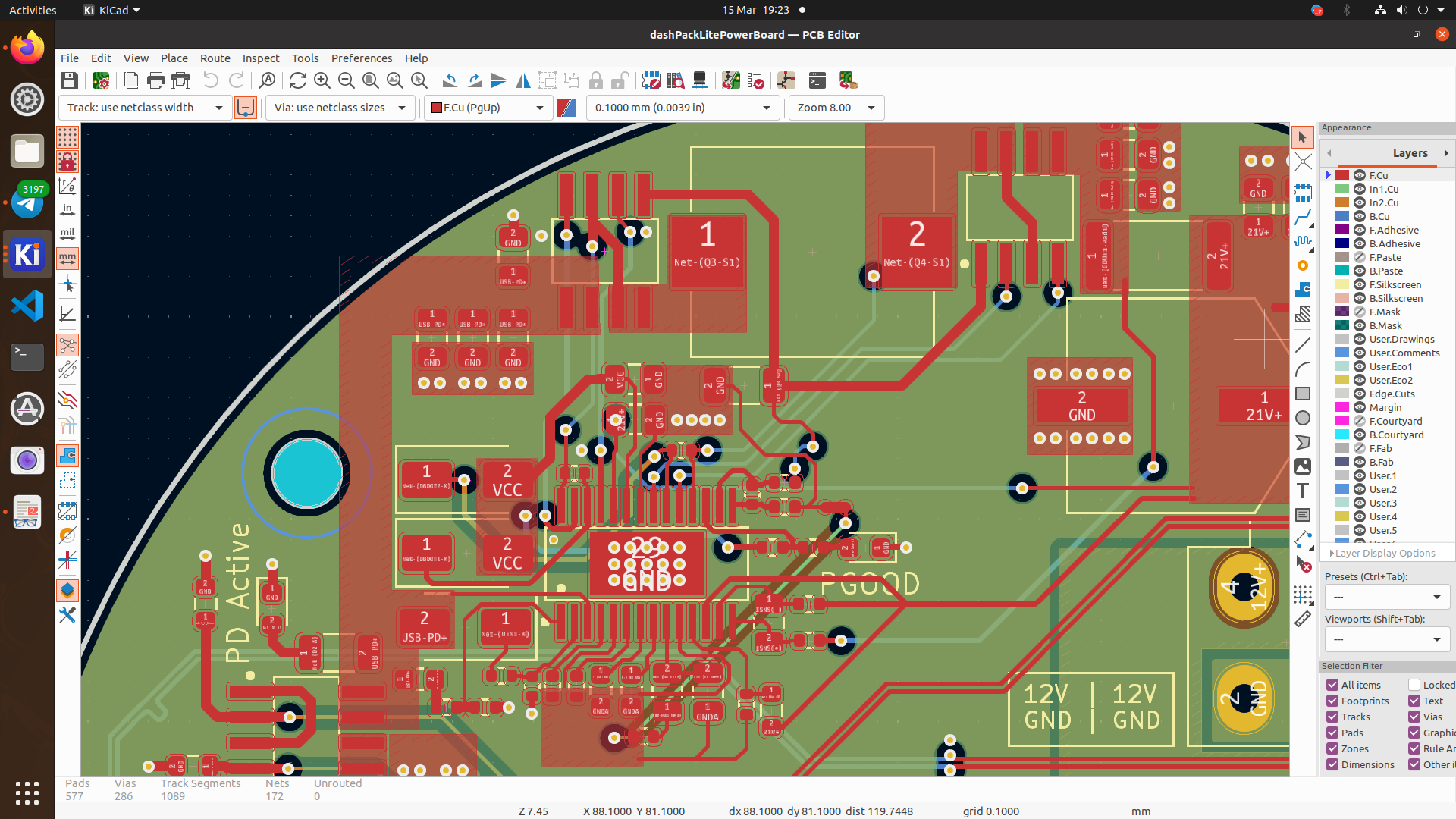

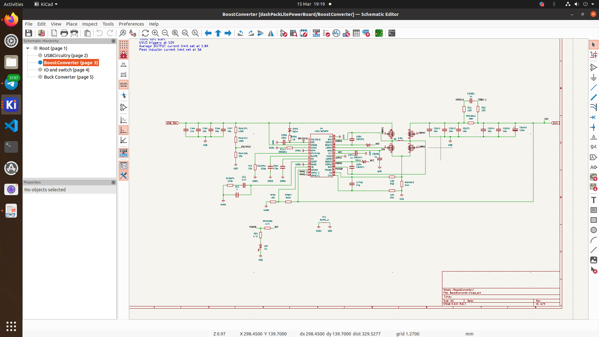

I have designed a dc-dc  converter using the LM5176. However, when I connect it to power, it is only able to work if I touch my finger to the capacitor on the comp pin. I am assuming that this is due to the extra capacitance brought by me touching the capacitor on the comp pin. I would like to request a review of my loop compensation values and layout.
LM5176 Buck-Boost Quickstart Tool.pdf
Schematic
Layout (Pin 1 is on the bottom left)
Thank you!

    How does you circuit behave with and without you finger on the COMP cap? Can you maybe send some scopehots of Vin, Vout and both switchnodes?
    I would recommend to go lower with the crossover frequency (to 45-50kHz max.)
    Best regards
    Moritz
